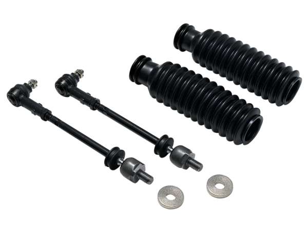

You'll want the whole thing, not just the ends:
(IMG:http://www.914world.com/bbs2/uploads_offsite/htsmall.automotion.com-179-1316115068.1.jpg)
