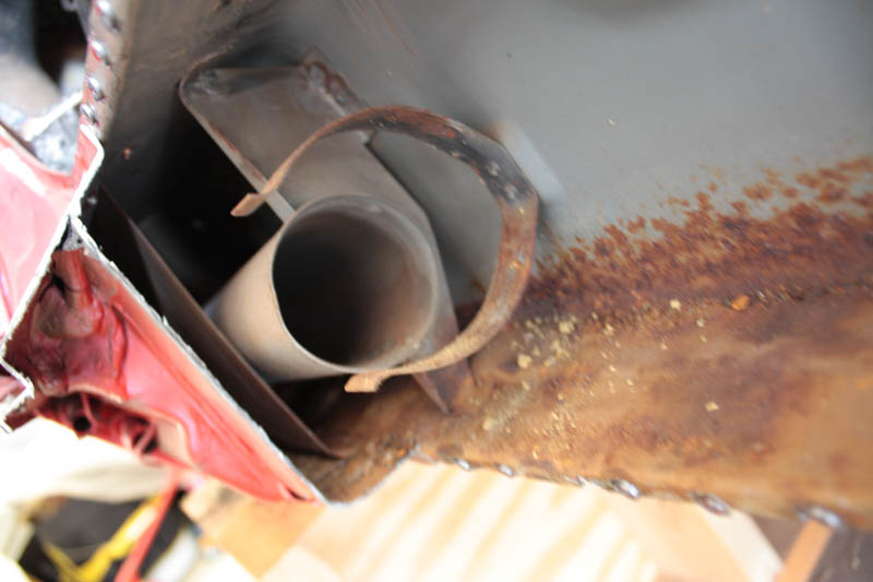

Now that the passenger side is welded up, I have moved on the drivers side and I am pleasantly surprised. There is definitely some rust but as far as I can tell it is all surface rust. It was almost not worth taking it apart but while I am here I will go ahead and replace most of the rocker/outer long with a new piece (I already have it). The front under the door jamb doesn't look that bad so I will try to sand blast what I can and Ospho the whole thing but not open it up like the passenger side
