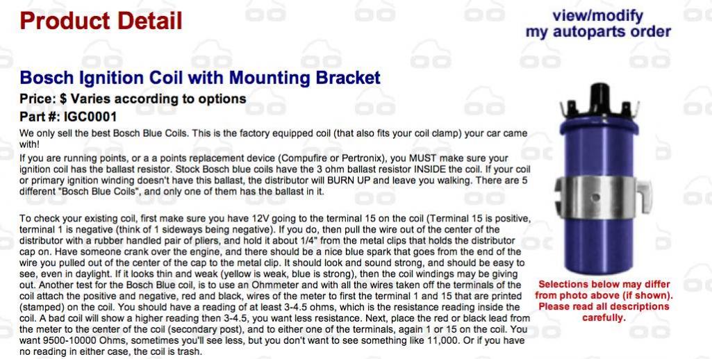

No condenser or (bad) low resistance condenser burns points. Running a coil without an internal or external resistor burns points. Nothing special about the blue coils. below is some info about testing the internal resister of a coil, courtesy of aircooled.net.
Does a worn coil eat points? Perhaps by oscillating, the "loose" rotor changes the duration of the points (dwell)? I'm not familiar with misadjusted dwell causing point failure but why not?
Is the 009 distributor a Bosch 231 174 009 that was (per: Anders) specified on 1973 2.0 liter 914's, or a copy of the mechanical advance only unit as seen on hundreds of thousands of VW's? (Though Bosch is selling these again) If the latter, then a replacement costs around $60 dollars for the knock off, or $120 for the "genuine" Bosch.
