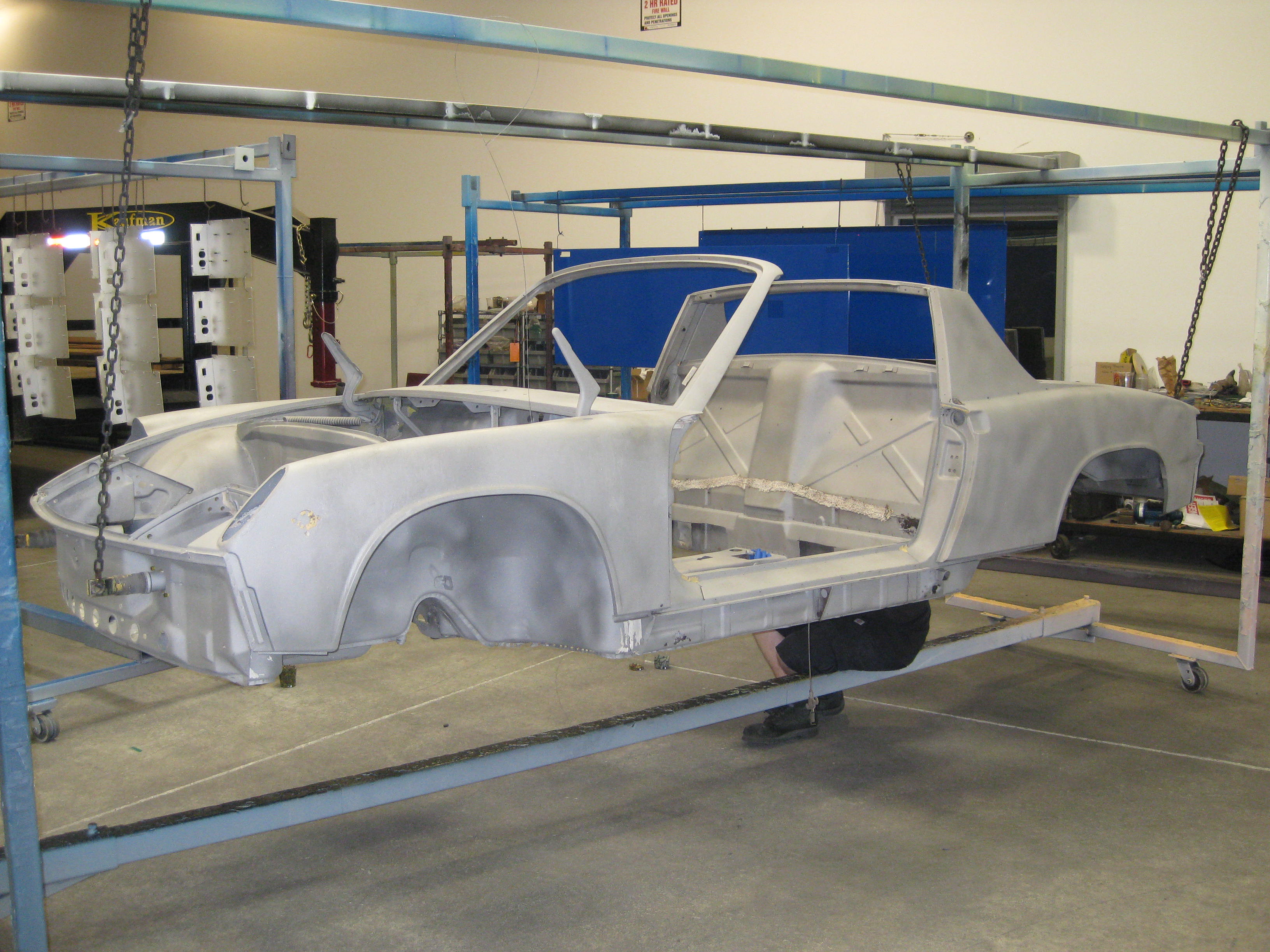

So with as busy I've been lately with work, I got tired of looking at my unfinished car (blasting was never finished by the first guy). I started to chemical strip the remainer of the car but was getting frustrated with the time it was taking and the fact that the rest of the car was flash rusting as time went on. My Ospho wash worked well but there was a fair amount of prep time in being able to do that.
I met a guy a while back who runs a powder coating shop but had not had a blasting capability.............until recently!
I brought the car (still on the first blasters rotisserie!) to the second guy. Last week he blasted the entire car again for me with aluminum oxide and then powder coated the car. Enclosed are the pics. Can not express how my somewhat OCD self is excited. Now I can work on little bits at a time without having to worry about rusting somewhere else and paint remnants here and there (that was driving me crazy, I couldn't see the forest through the trees!). I can grind the coating back down to do welding etc and just have to prime back small parts instead of an entire car!

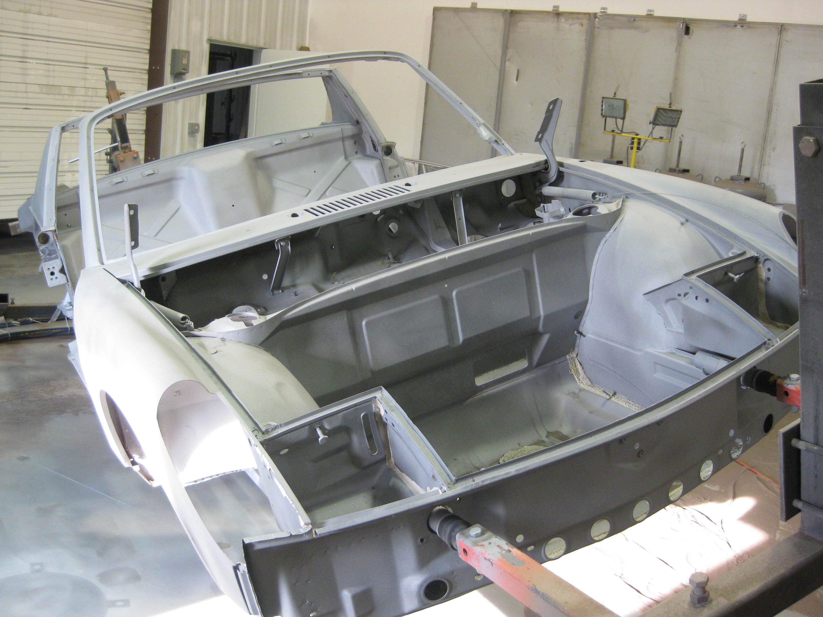

993inNC   So far this is all I can find for real damage in t...   Feb 26 2010, 01:07 PM

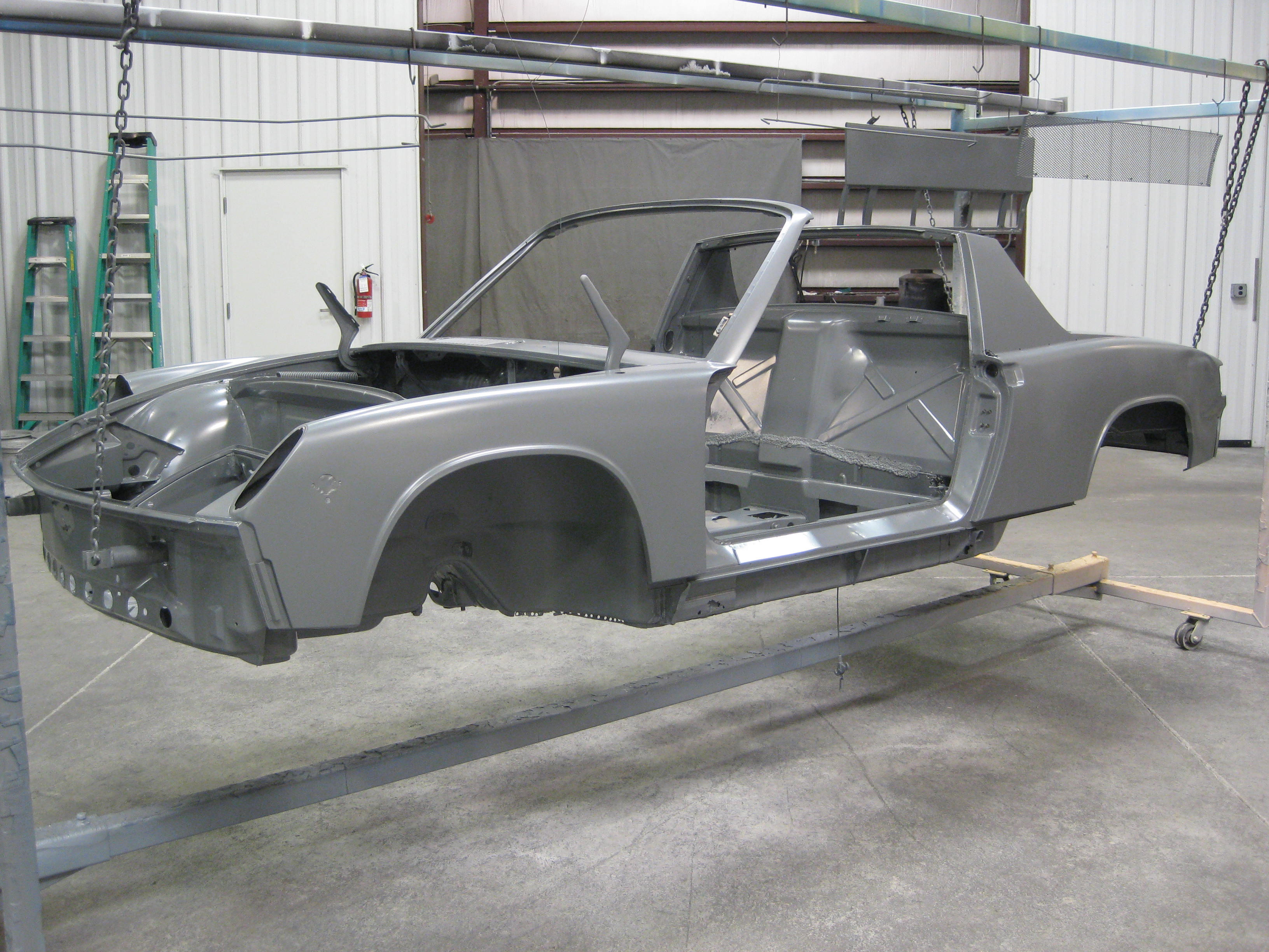

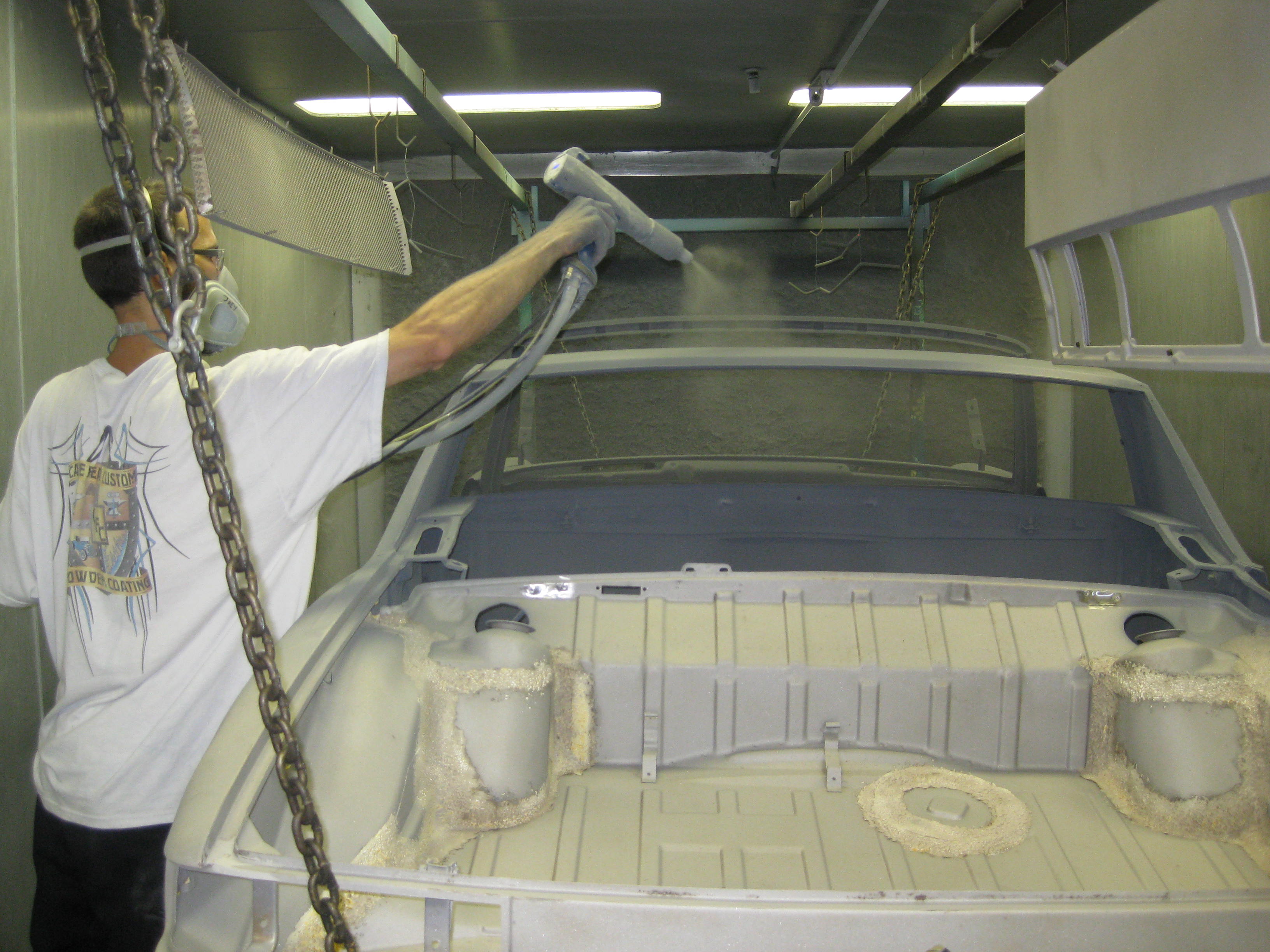

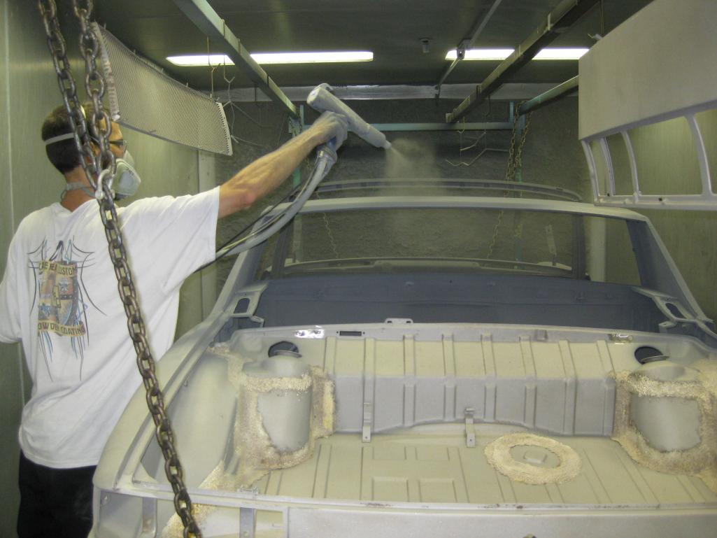

993inNC   So with as busy I've been lately with work, I ...   Oct 3 2011, 08:26 PM
CrashDown   good luck man, that powdercoat is gonna be a bitch...   Oct 3 2011, 08:56 PM
jaxdream   First completely powdercoated 914 ???? :Qarl: :Qa...   Oct 4 2011, 09:40 AM
Ductech   Have any of you guys ever scraped powdercoat out o...   Oct 4 2011, 01:28 PM
993inNC   Have any of you guys ever scraped powdercoat out ...   Oct 4 2011, 06:29 PM
trojanhorsepower   Woo Hooo :Qarl: Progress! I can't beli...   Oct 4 2011, 07:06 PM
993inNC   Woo Hooo :Qarl: Progress! I can't bel...   Oct 4 2011, 07:13 PM
Philip W.   Woo Hooo :Qarl: Progress! I can't be...   Oct 6 2011, 06:23 AM
993inNC   [quote name='993inNC' post='1549458' date='Oct 4 ...   Oct 7 2011, 05:26 PM
mepstein   I'm curious about the powder coating. Your guy...   Oct 7 2011, 07:17 PM
sixnotfour   Once you smell powder burning while welding, you w...   Oct 7 2011, 09:15 PM
993inNC   I'm curious about the powder coating. Your gu...   Oct 8 2011, 01:16 PM
