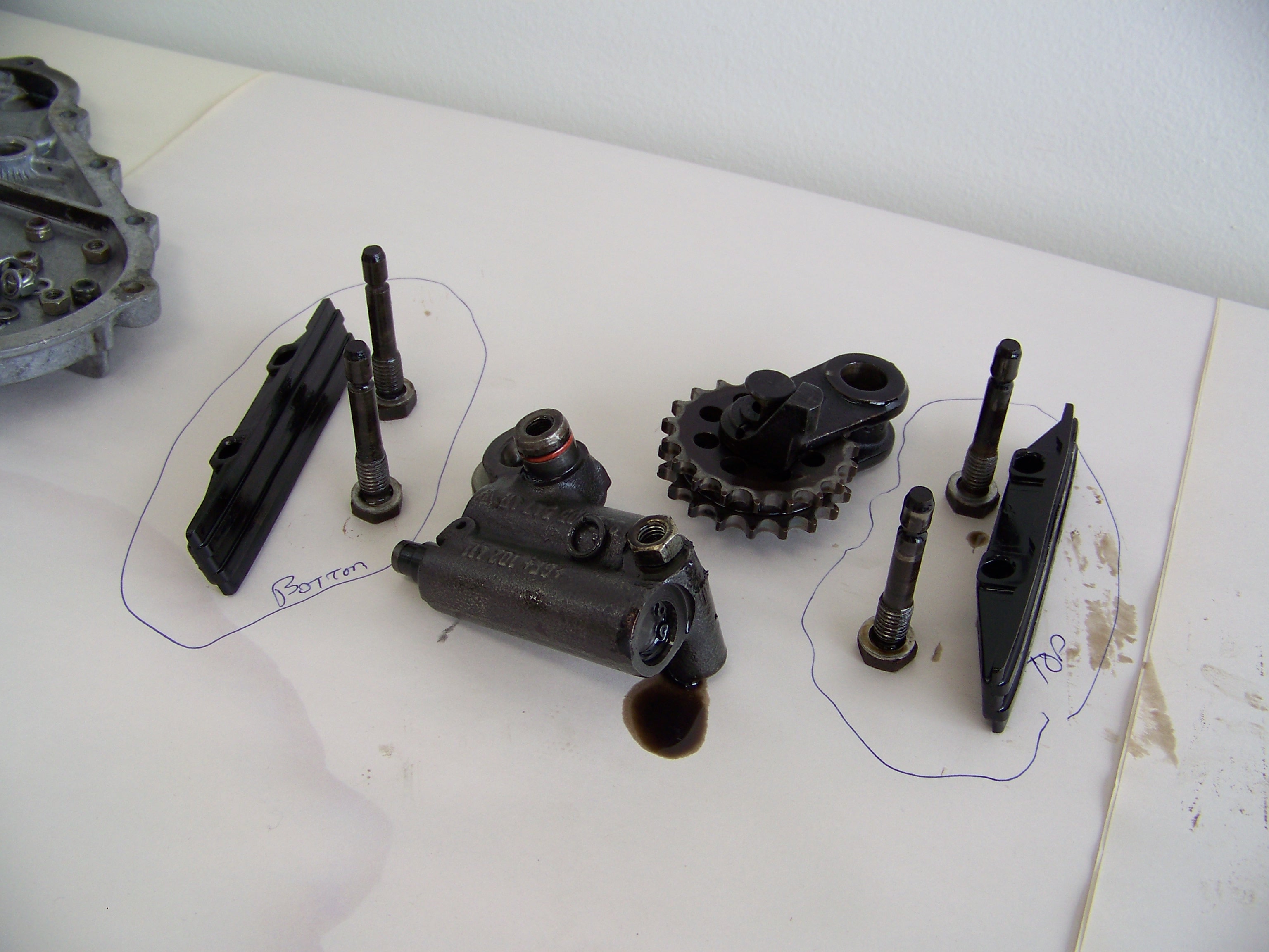

Anyone out there care to watch me take apart (and hopefully put
back together) a 3.0? I can't start at the beginning because I picked
it up from a shop in this condition. Well actually it was alot uglier.
Years of oil leaks had baked on to nearly every inch.

I'm going to try to keep track of what part goes where
