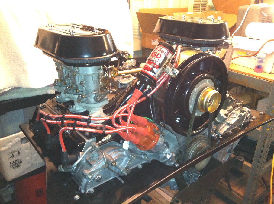

Anyone out there care to watch me take apart (and hopefully put
back together) a 3.0? I can't start at the beginning because I picked
it up from a shop in this condition. Well actually it was alot uglier.
Years of oil leaks had baked on to nearly every inch.

I second the Wayne Dempsey book, which is what I used.
You will still need to go to the 911 engine rebuild forum on Pelican to 'fill in the gaps' if you don't understand a passage in the book.
It is not that hard, but you must be patient and meticulous. It's nothing like working on an American V8.
