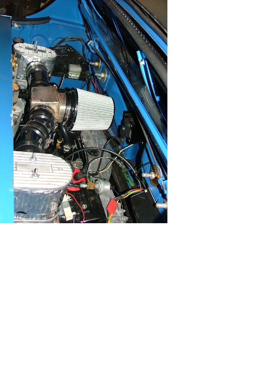

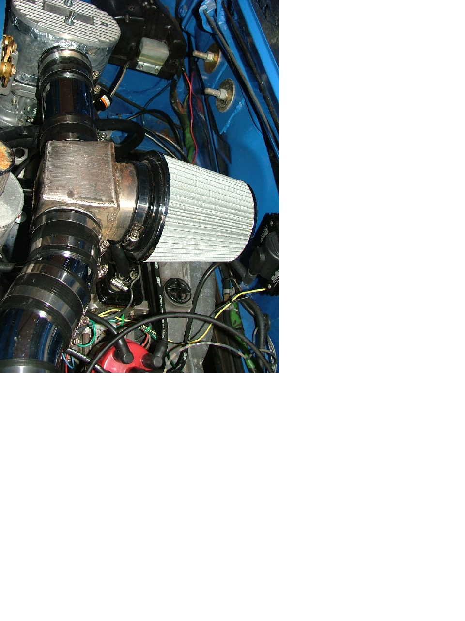

I apologize if this is a hijack. I would like EFI for a lot of reasons as well but I
thought I would see in a quick and dirty way how much the carbs could be
quieted down.
The carb tops and plenum are just welded up exhaust pipe and 20 gauge sheet
metal. I put eastwoodmat around the carb tops. The tubing, couplers, and cone
filter are cheap FLAPS parts.
I need to do some more tests but my initial results are 88 db with itgs at 900 rpm
and 82 db at 760 rpm with my cheesy intake system. I was getting 104 db at
2600 rpm with itgs and never took a good reading with the new system at that
rpm. I'll get on that.
Now I can hear the exhaust a little but also a lot of general air cooled noise that
is not intake related.
This seems to help low end throttle response but obviously would be restrictive
past a certain rpm.
John
