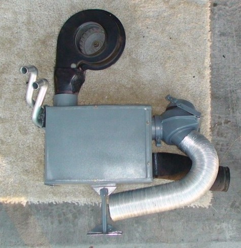

Here is the system I have now and I am ready to pull it out.
My motor runs cool and I need more heat.

QUOTE(ruby914 @ Oct 16 2011, 08:52 PM) *
Care to sell that? (IMG:style_emoticons/default/biggrin.gif)

QUOTE(BajaXJ92 @ Oct 16 2011, 08:08 PM) *
You know what they say about one mans trash...
Soon as i come up with something that works better for me, its yours.
