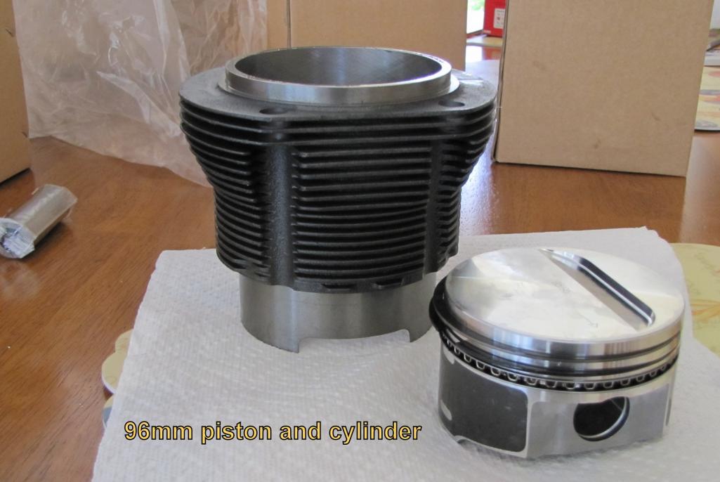

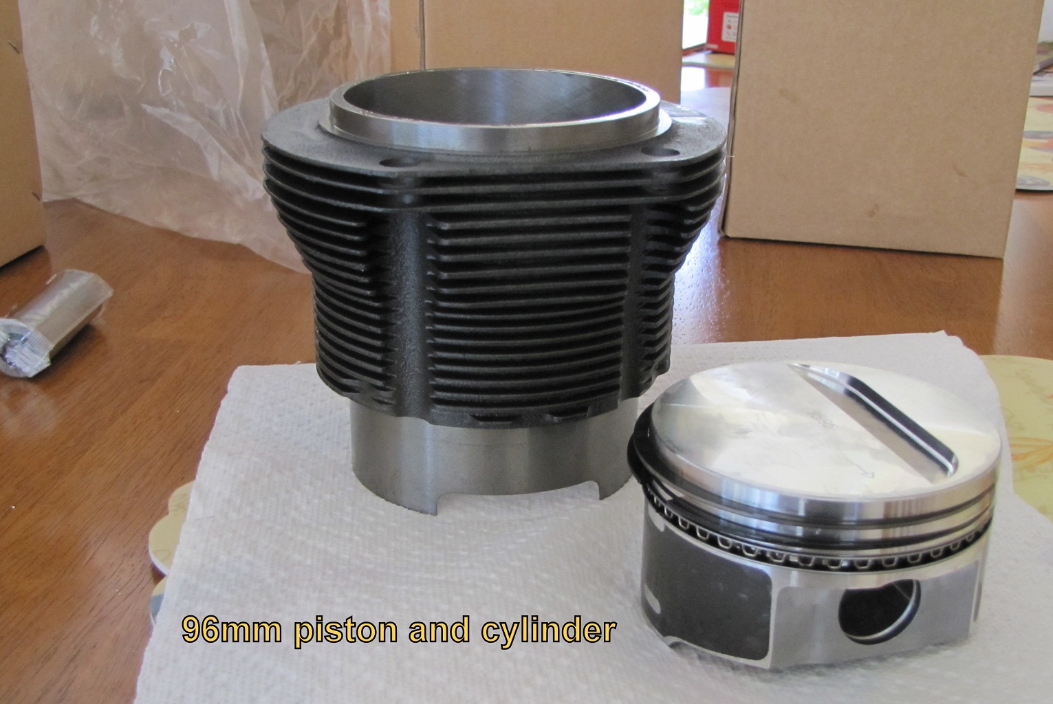

New stuff is starting to arrive!!! (IMG:style_emoticons/default/piratenanner.gif)
Here is what I received today: 96mm pistons and cylinders.
Still waiting for the oversized main bearings before any work can be done on the case.

vsg914   Is that the top left or the bottom left? :stir:   Oct 20 2011, 02:51 PM
Valy   Those are AA pistons. Measured the ring gaps in t...   Oct 20 2011, 07:42 PM
