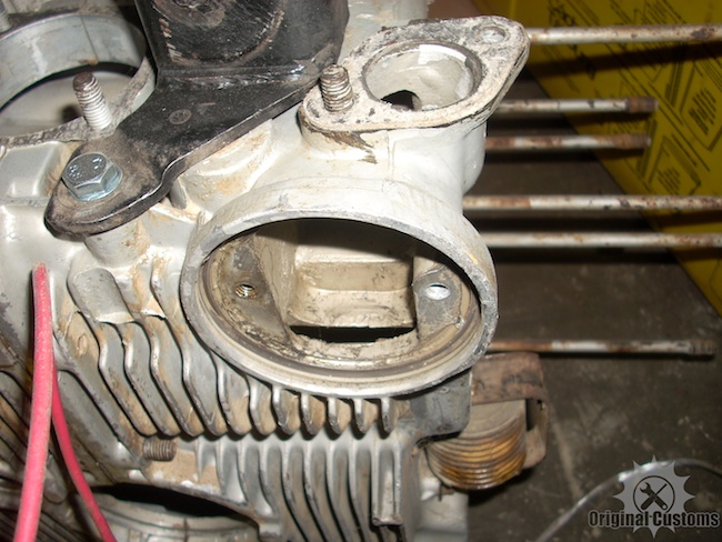

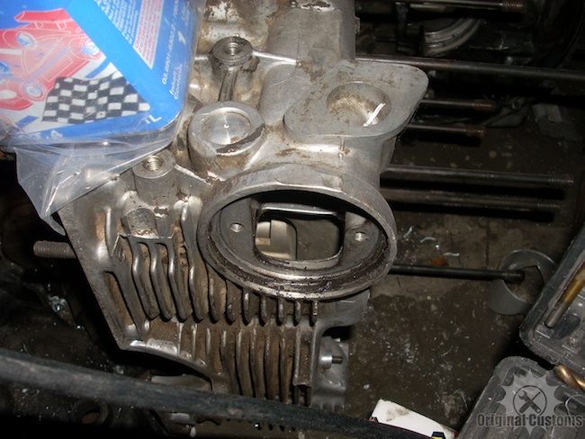

Today I got pistons 3 & 4 out.
#3 looks nice, not too much signs of wear. The ring gaps are about 1mm (trash)
#4 is also nice but the piston got a small bent while trying to remove the pin. That bent trapped the oil ring. Never mind, I'm going for bigger one anyway.
The cylinder registers are nice. In fact, the entire case is very nice and clean.
Anyone knows the meaning of the inscriptions on the cylinders and pistons?

Yup, use the tabs and pry it off. I'm sure someone out there has damaged a case doing that, but use your head and pry carefully and you'll be fine.
You know you gots a bus case there? Not that it matters much, but that blocked off passage just above the taco plate is where the bus dipstick and oil filler tube go.
