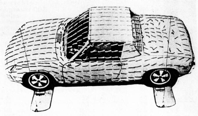

I don't want to do any major cutting on my conversion. My goal is to have 2 usable trunks, and a car that can be easily converted back to a stocker. There have been a few threads where the possibility/impossibility of an engine bay radiator. Here's my take on it. I believe that at 25+ mph there is a low pressure spot behind the back window. I think this will be enough to suck air up through the engine compartment.

Rand   My $.01 opinion is the natural airflow debate...   Oct 24 2011, 02:12 PM
Dave_Darling   Jeff's tuft testing photo there matches the pi...   Oct 24 2011, 05:22 PM
Rotary'14   Jeff's tuft testing photo there matches the p...   Oct 24 2011, 05:35 PM
kg6dxn   Jeff's tuft testing photo there matches the ...   Oct 24 2011, 06:29 PM
