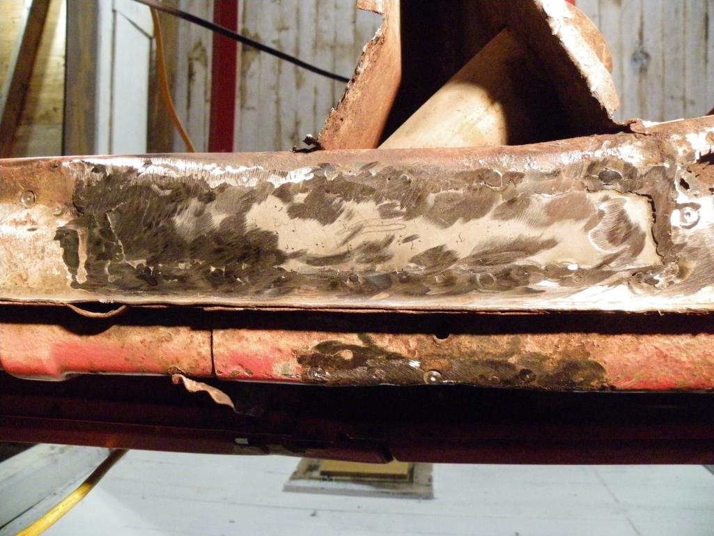

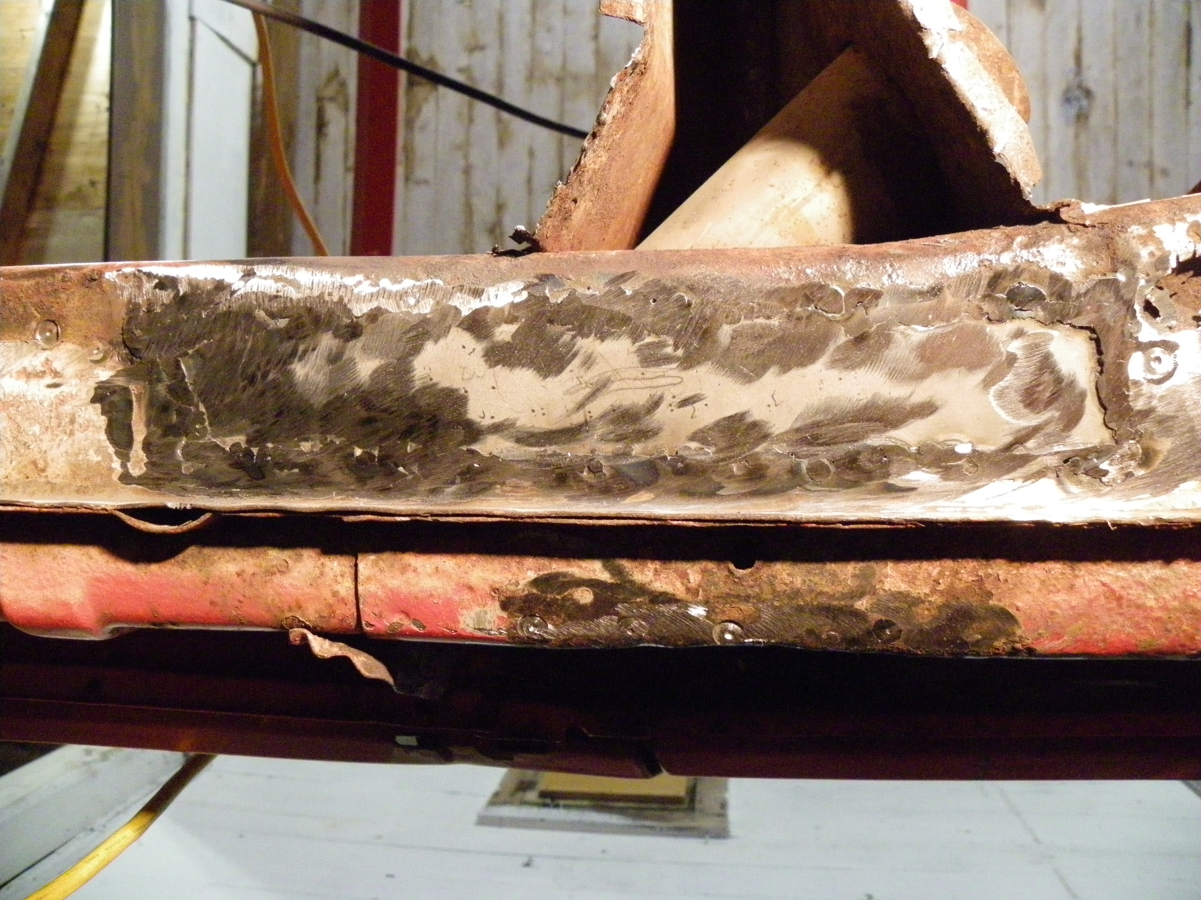

Well.. All settled into the new house and got the garage cleaned up enough that I could move around so I final got to do something with the 914 I haven't done yet... Put something ON the car.. (IMG:style_emoticons/default/smile.gif) welded in a small patch on the underside of the frame that will be covered up by the rear floor pan.. I'll post a pic here.. The welding looks pretty brutal in the pic.. This is the first time I've welded ON a car and I was on my back too.. ugh. I went over the welding again after this pic and ground it down some more so this is a " in process" pic...
