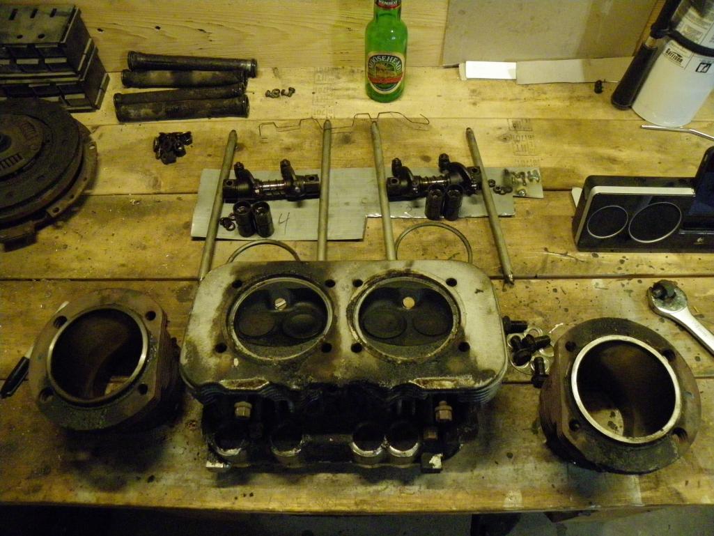

I also got an engine stand/yoke in and popped the engine onto it so I could begin tearing it down. got the sheet metal, FI off and then the valve train, heads, cylinders.
The heads look better than I thought they would... no big visible cracking around the spark plug, and it looks like all the seats are in decent shape for 40 years old.. the exhaust studs are pulled on one of the heads and were tack welded to the heat exchangers which was fun convincing them to let go, but it doesn't look like significant damage.
What I was most surprised with was the condition of the lifters.. A couple of them had a very slight dish in the centre that you could only really see if you tilted it away from the light and got a shadow on it, but most of them looked absolutely spotless. I was expecting to see some FOD damage or scratches or heavier wear or SOMETHING..
I also popped off the oil pump to have a look since theres been a few threads lately about failing oil pumps... Mine looks like its in good shape.. I'll be replacing it anyways, but its nice to know it wasn't about to go boom.
