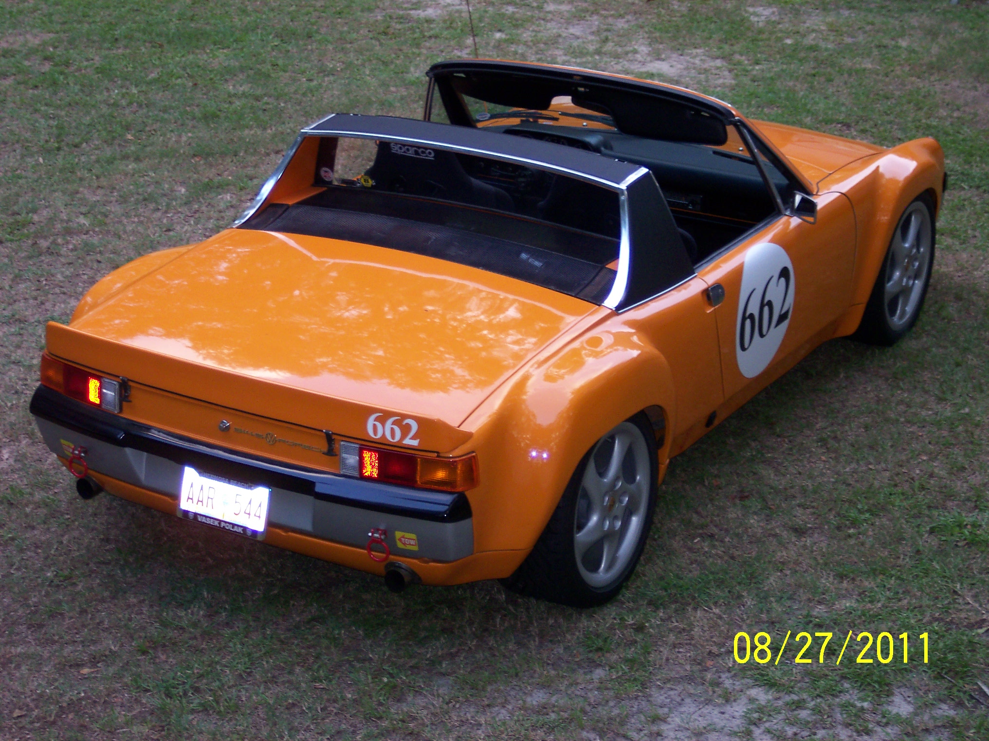

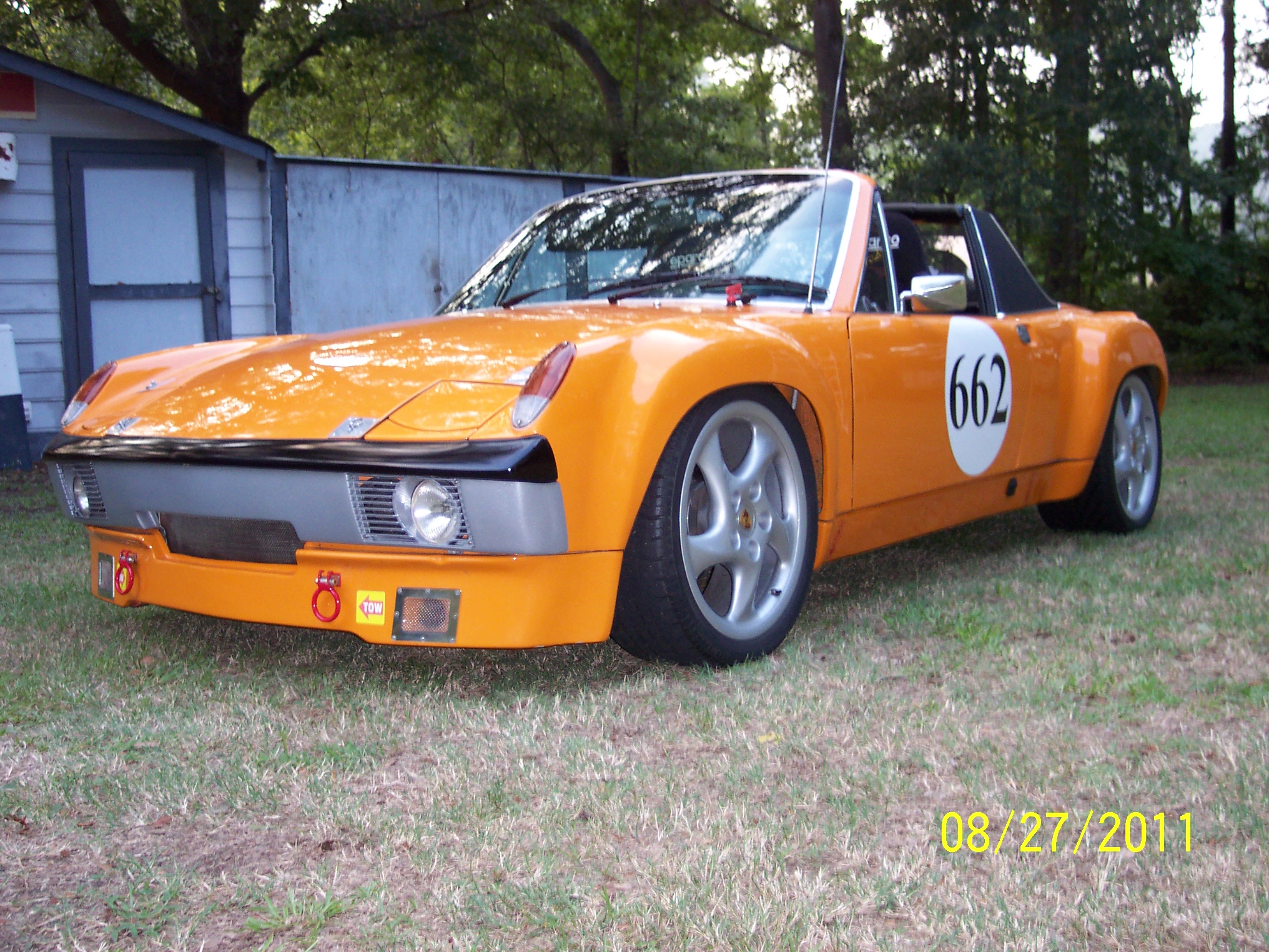

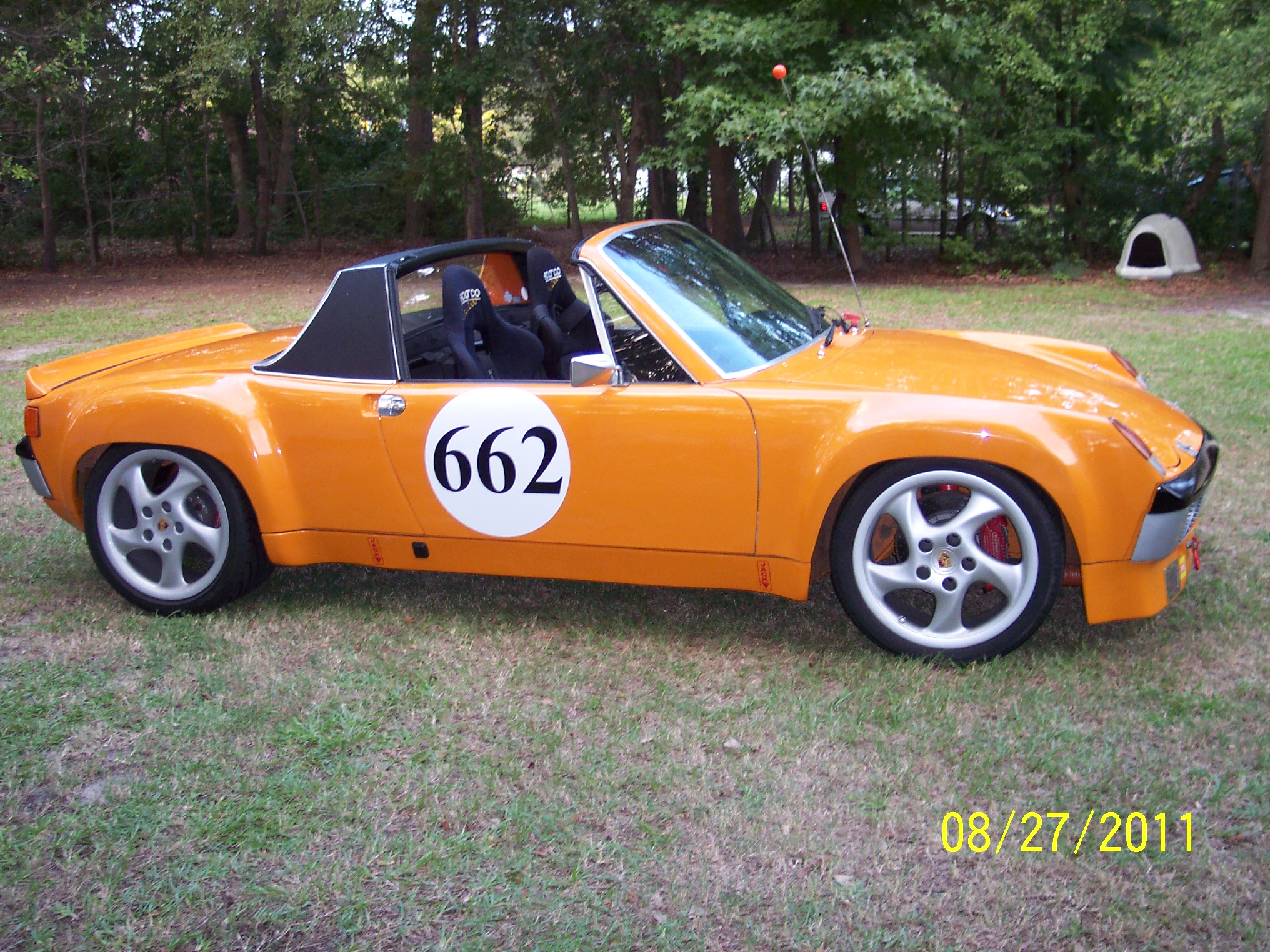

On mine, I'm running 18'' twists on both front and rear.
Oddly, all four wheels started out as 18x10's with a 40mm offset. i sent them off for refinishing, and had 2 of the wheels narrowed 2'', and those two are used for the fronts.
The fronts are mounted on 1979 930 hubs with the factory 1''spacer.
The rears are mounted on the 914/6 hubs with a bolt on 2'' spacer.
Everything fits good, with no rub front or rear.
