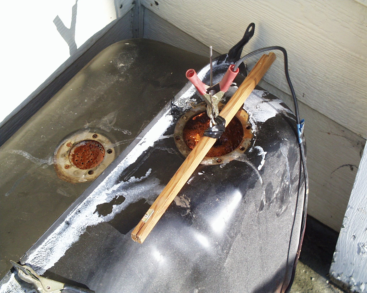

Here's a couple of shots of my tank in progress
The tank
The electrode (a rolled piece of heavy gauge sheet metal)

Phoenix-MN   Here's a couple of shots of my tank in progres...   Oct 29 2011, 11:46 AM
rick 918-S   Here's a couple of shots of my tank in progre...   Oct 29 2011, 01:58 PM

Phoenix-MN   Seems like something I might try. How long would ...   Oct 29 2011, 01:48 PM
Phoenix-MN   Here's a couple of shots of my tank in progr...   Oct 29 2011, 04:34 PM
kwales   I've separated a 1/8 thick strip of mild steel...   Oct 29 2011, 05:04 PM
