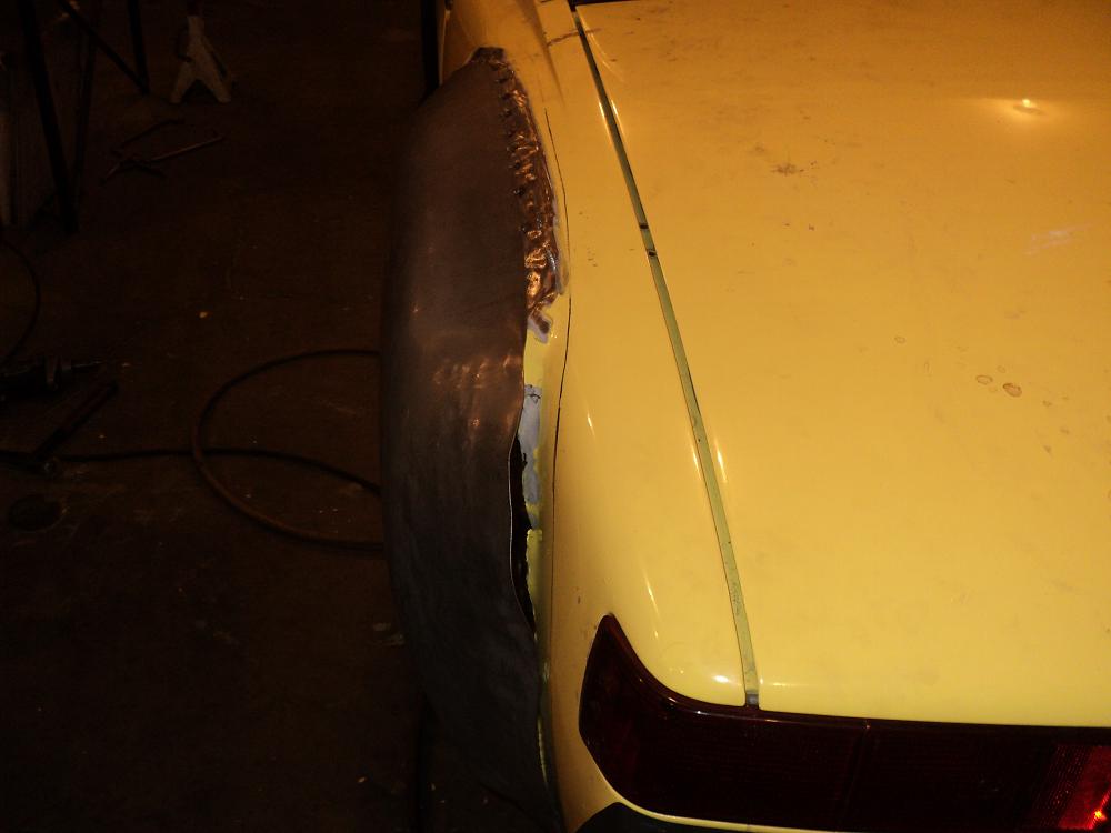

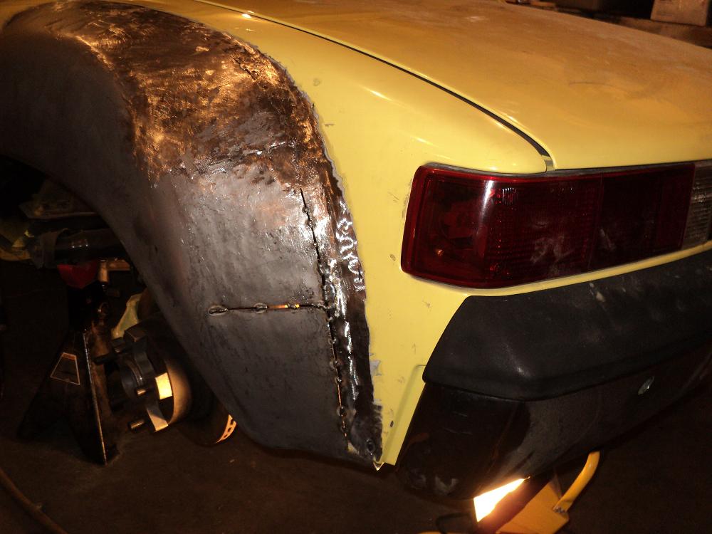

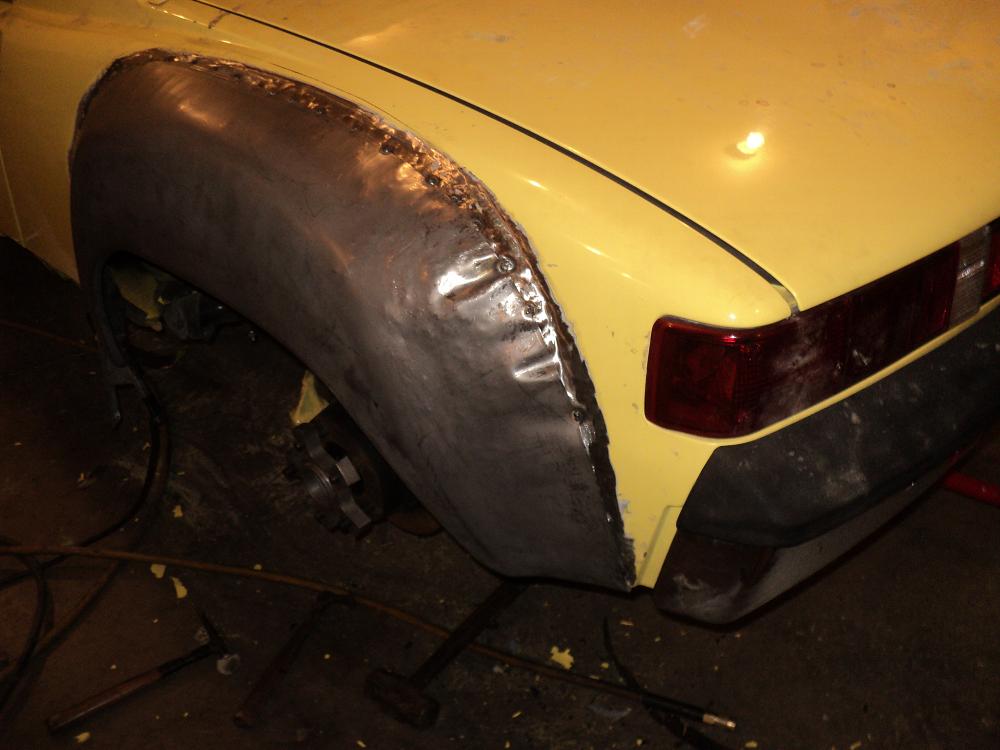

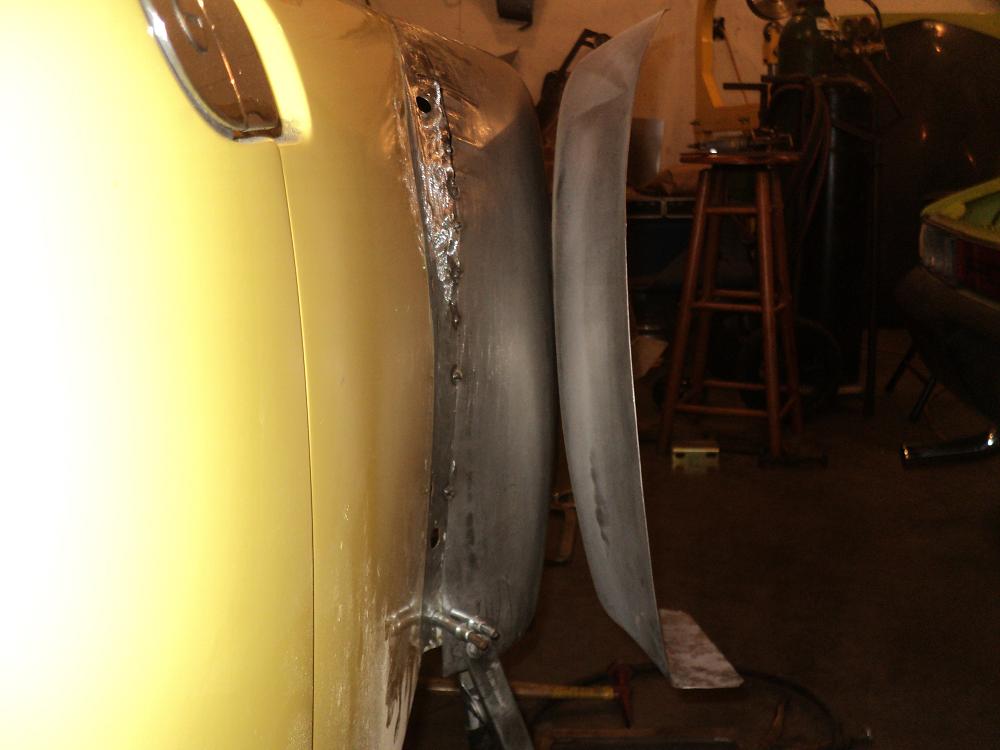

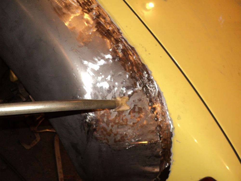

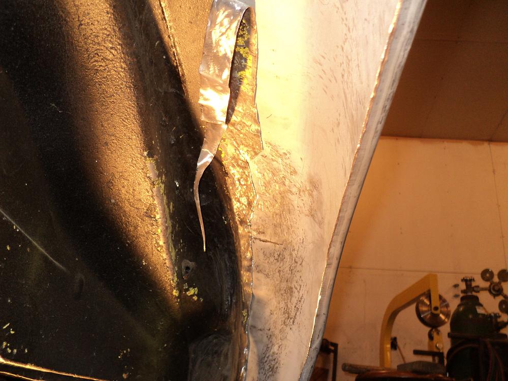

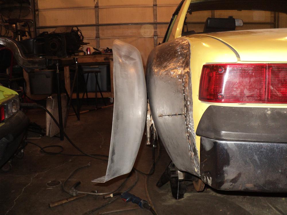

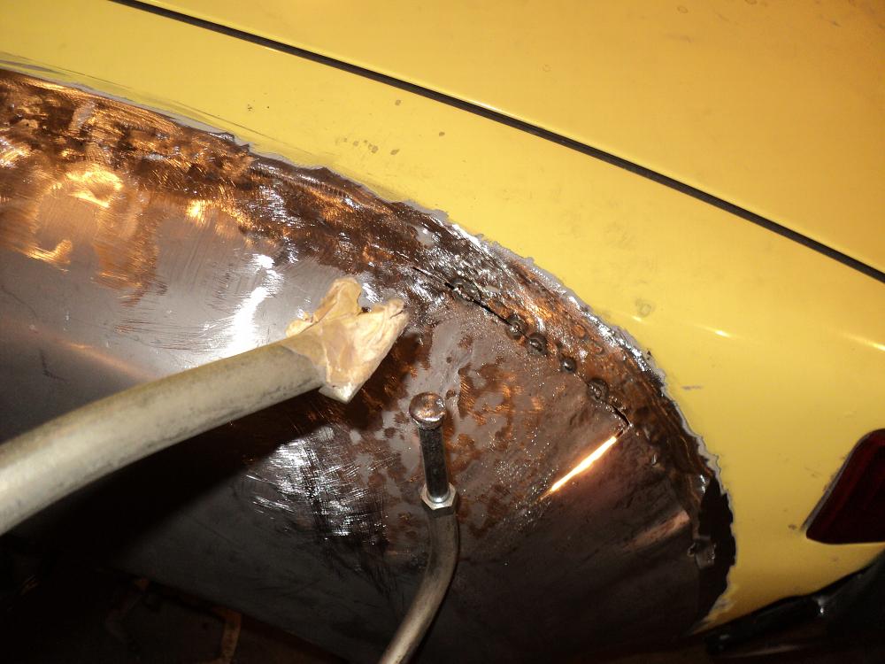

Here ya go guys. Here's a couple from the first day. The rear track is fat so I couldn't just install the flares as everyone else. The sharpie line is where the flares fit without modification. I moved them almost 2" out from the line. These first two photos will kind of give you the impression that I ruined a good set of flares and it will be a miracle if they are even useable anymore. No worries. (IMG:style_emoticons/default/shades.gif)
(IMG:style_emoticons/default/unsure.gif) (IMG:style_emoticons/default/unsure.gif) (IMG:style_emoticons/default/unsure.gif) (IMG:style_emoticons/default/unsure.gif) (IMG:style_emoticons/default/unsure.gif) (IMG:style_emoticons/default/unsure.gif) (IMG:style_emoticons/default/unsure.gif)
I am butt welding these and shaping them as I go. I find it easier to tack them over the stretched lip of the original panel then cut through and hammer and dolly the two edges to line them up, then weld the gap. Here's the underside showing the waste strip I pull down as I move about 3-4" at a time.
The next set is showing a bumping tool I use to shape the panel as I go. I bump the low spots with this tool and a pointed one I have, hammer and dolly the highs and file the panel.
This is as far as I got today. It's starting to take shape.
And here you can see how much I had to modify the flares to fit the fatness. Lots of welding, grinding, planishing and filing before it's done.
