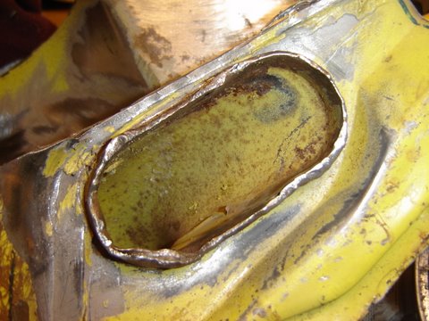

> Oval end of the door jamb vent tube..., how is it fastened to the inner ply?
TargaToy
post Oct 29 2011, 02:00 PM
-NONSOLIS RADIOS SEDIOUIS FULMINA MITTO-
Posts: 714
Joined: 26-March 10
From: DelMarVa Peninsula
Member No.: 11,509

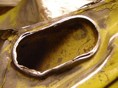

Sorry for the crappy pics. Shot 'em fast for the sake of the question.
A member here (thanks Doug!) hooked me up with some good vent tubes/door handle recesses to replace the rotten ones in my car.
I'm cleaning them up and removing the sealer, etc.
How are the oval ends of the tubes fastened to the inner ply? It appears there's an oval inside an oval (2 plys) if that makes sense. Are they spot welded together? Brazed? Friction fit?
I'm trying to get the oval end of the tube out of the inner skin while keeping the round end attached to the jamb end.

Man, am I glad I stopped to ask how to separate these tubes. Thanks for the advice. Did some light grinding to find the seam between the two plys in the ovals and they came apart very easily. Blasted these parts in a friend's cabinet yesterday. The rust is gone but the traces of sealer I didn't remove completely with heat and a chisel didn't respond to the blasting. Will just have a little more clean-up to do on them.
Thank you again for the pics and recommendations.

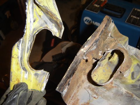

nathansnathan   I just took the tube out of my car. Here's the...   Oct 30 2011, 03:59 PM
TargaToy   Thanks for nothing. Now I've got to explain t...   Oct 30 2011, 07:37 PM
nathansnathan   The same part before may help you make your case, ...   Oct 30 2011, 10:37 PM
