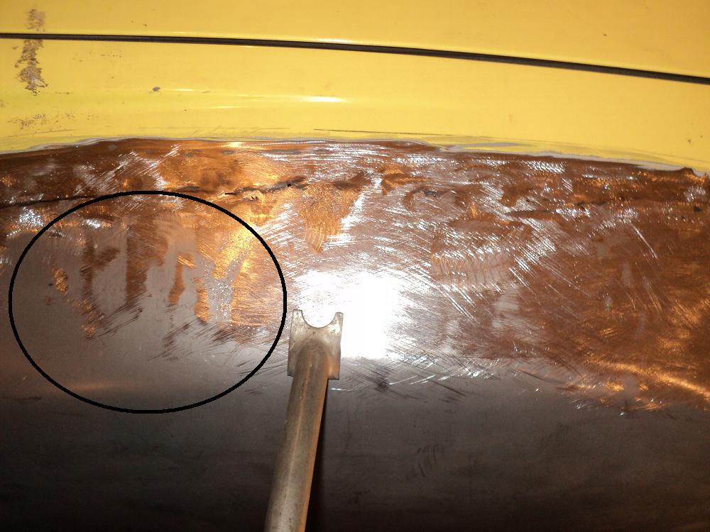

rick 918-S   Starting to shrink the extra metal from reversing ...   Nov 12 2011, 02:10 PM

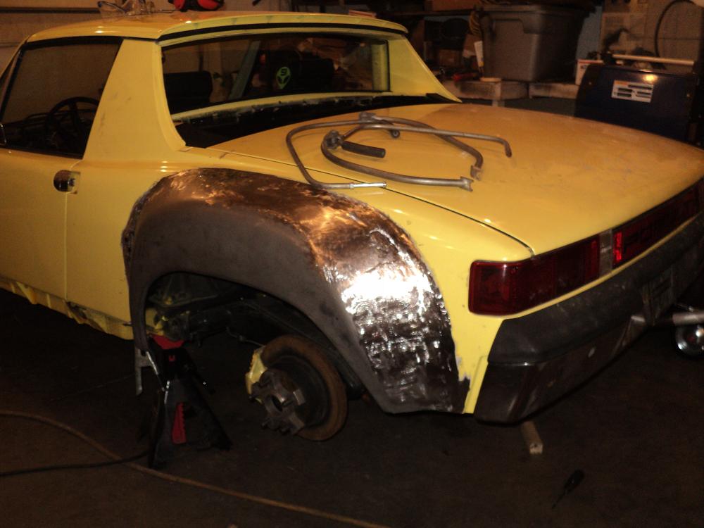

rick 918-S   Lots of bumping and grinding yet but here's a ...   Dec 12 2011, 12:04 AM

rick 918-S   More bumping and shaping. the last couple nights. ...   Dec 15 2011, 12:07 AM

rick 918-S   These fronts are going to be a bitch to fit. As I ...   Dec 17 2011, 01:02 PM

rick 918-S   Yep, Very mild here. :D Here's a sample of t...   Dec 18 2011, 12:44 AM
rick 918-S   The flares were too close to the tires so I raised...   Dec 24 2011, 12:28 AM
