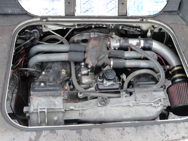

I just finished a similar conversion for my '67 Squareback. I transplanted a '73 914 2.0L and converted it to MS2 V3 w/ EDIS using the stock 2.0L runners and a 1.8L plenum (clocked about 3/4" on the fwd mounting only so the runners would line-up) and a slightly modified 2.0L TB. I get my CLT temp from the LH valve cover. I switched to a Walbro pump. The injectors are yellow-top Type-3 D-jet injectors which flow almost as much as the stock green-top 2.0L type. I have had no fuel starvation with these
(IMG:http://www.914world.com/bbs2/uploads_offsite/images.thesamba.com-9730-1320682118.1.jpg)
I've been meaning to pull it all apart to get it all powder coated, but I just enjoy driving it too much. . . It drives like a scalded cat!! When I get the car painted I'm going to have the pin-stripper badge it "SB Type-P SS" ("Squareback, Type-Porsche Super Sleeper").
Mine has EDIS, but if you want the MSQ-file, shoot me your e-mail address and I'll send it to you. It'll get you in the ball-park for your motor and have a good starting point anyway.
