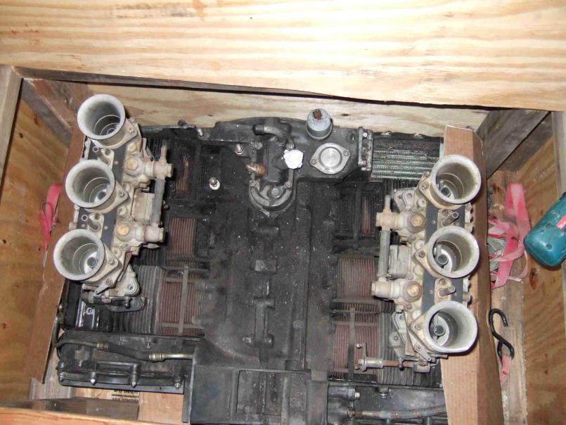

Had converted my 1973 to a /6 15 years ago and had an engine failure at a track day, and it has been apart and in boxes since. Finally decided it was long enough without my 914 in my life, so started to get it back together. Here are few pics of what I have been up for the last few months in my spare time.
Engine: 2.4 w/ 2.2 S pistons, Solex Cams, 40 IDT Webers

Reminder engine is 2.4, 2.2S pistons, solex cams with weber IDT carbs with 34mm venturies. Compression ratio is about 11:1 or less, standard small port heads and valves.
When you get that carb dialed in can you let me know the particulars (vents, jets, ET, etc..). I also have IDT's and building the same engine. Did you go with an E or an S dizzy? When you say small port heads do you mean the smaller T port size and not opened up to S?
Here's my 2.4 and IDT's in dire need of a rebuild.
