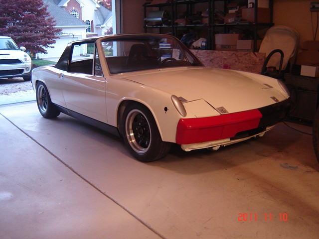

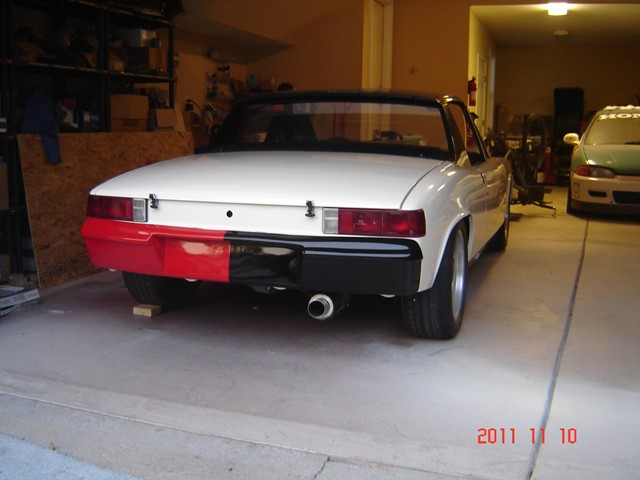

update.
I finally finished the paint job and it's now re-assembled. The paint job turned out ok, but could have been better. Too much orange peel. I learned alot, and the next paint job will be much better. It's respectable for a track car. I still need to add the targa trim and the all black fuchs. and geta front valance. Also thinking about a porsche side strip in red.
My winter project will be to build a short ratio transmission and to put some tags on it so I can start sorting it on the street in preparation for its track debut next year.

QUOTE(fasthonda @ Nov 9 2011, 05:52 PM) *
update.
You can color sand orange peel out, but find someone that has done it before to teach you the tricks.
I think your car looks great. You'll be proud rolling her out on to the track.
