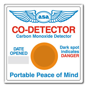

A simple cheap insurance is one of these. You can pick them up and may airport FBOs (fixed base operators) for less than $5. Just look up learn to fly and your local airport and call to see if they have them. Or buy from ASA directly.
http://www.asa2fly.com/Carbon-Monoxide-Det...2_product1.aspx
