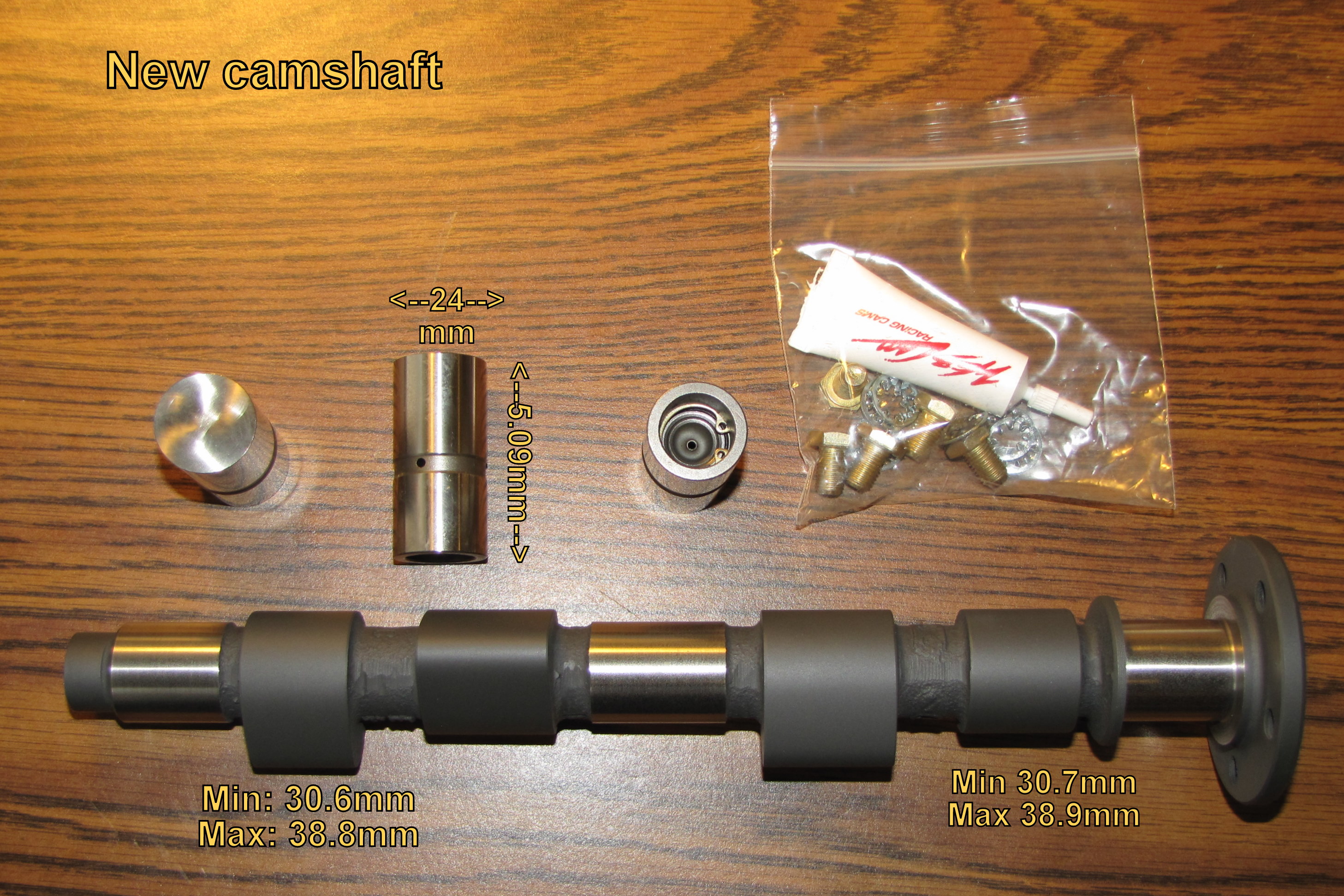

Cam is here (IMG:style_emoticons/default/piratenanner.gif)
Lift is 8.2mm (0.323") on each lobe although intake and exhaust lobes have different dimensions. Accounting for the x1.3 rocker ratio this is 10.66mm (0.420")
This is a bit lower than the cam card 0.426" (IMG:style_emoticons/default/confused24.gif)
The lifters are solid lifters but look a bit like the hydraulic ones. You can see a moving part inside the lifter hold by a C clip. There is no spring and valve behind it. Maybe this will make the valves a bit more quieter.
Lifter diameter is actually 23.98mm so it's within spec. My micrometer was not calibrated to the lower outside temperature.

Marty Yeoman   What WebCam part number is your cam?   Nov 11 2011, 02:14 PM
Valy   What WebCam part number is your cam? It's a ...   Nov 11 2011, 02:45 PM
Marty Yeoman   What WebCam part number is your cam? It's a...   Nov 15 2011, 02:25 PM
Valy   [quote name='Valy' post='1570171' date='Nov 11 20...   Nov 15 2011, 03:44 PM
Scarlet75   So thats not a Raby Cam?   Nov 11 2011, 05:00 PM
Valy   So thats not a Raby Cam? Nope. I bought it from ...   Nov 11 2011, 05:16 PM
