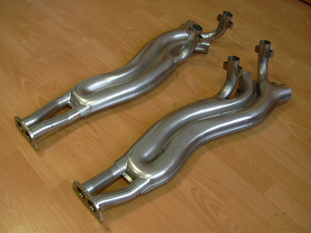

I'm pretty sure they are available new from Mittlemotor - pretty but pricey.
http://www.mittelmotor.de/webshop/englisch/mm.htm $1,200
