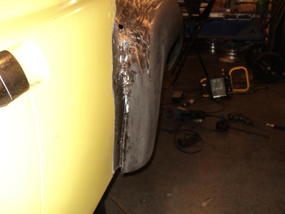

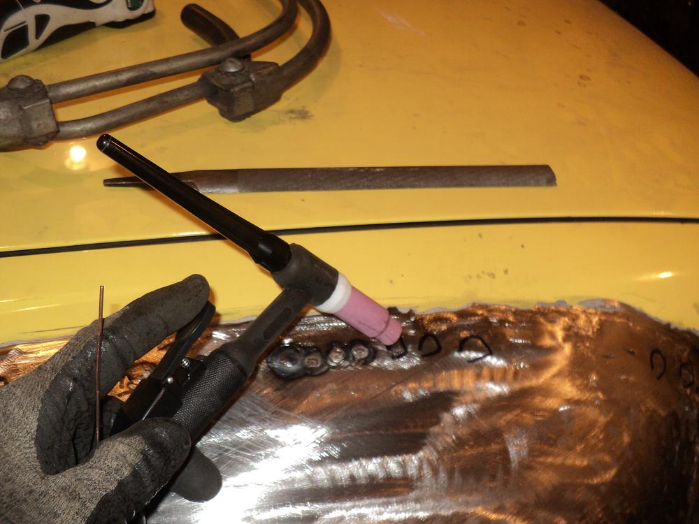

Starting to shrink the extra metal from reversing the shape of the flare to stretch it out.
Tigging up the little pin holes left from stitching the flares on with the mig. some are so small you can only see them with a light shining from the back.

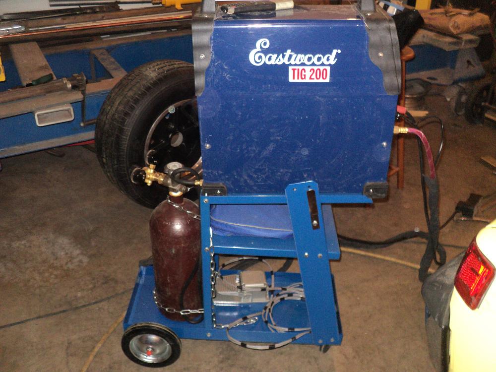

Oh, forgot to tell yous guys, I bought a tig... (IMG:style_emoticons/default/biggrin.gif)
