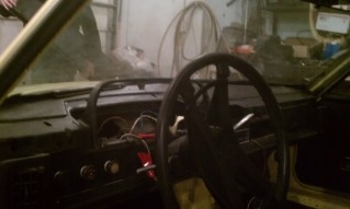

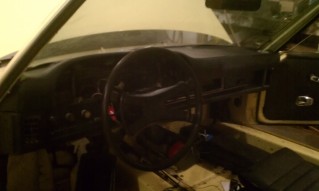

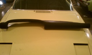

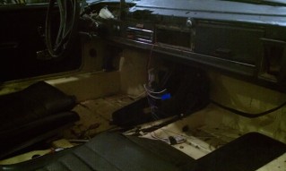

Dan and myself where up to Area 51 Weeks Sunday. Dan took some pictures of the flare Rick has been working on, beautiful work!! (IMG:style_emoticons/default/first.gif) A lot smoother then I could have imagined.
(IMG:http://i3%20:first:%2084.photobucket.com/albums/oo284/ijcjr40/74%20914/IMAG0109.jpg)
(IMG:http://www.914world.com/bbs2/uploads_offsite/i384.photobucket.com-9514-1321337646.1.jpg)
We also lowered the front suspension so the fronts can be fitted property.
Also installed the Getty dash. Unfortunitly we misplaced the gauge face plate (IMG:style_emoticons/default/headbang.gif) , so no pictures with the gauges at this time.
(IMG:http://www.914world.com/bbs2/uploads_offsite/i384.photobucket.com-9514-1321337646.2.jpg)
(IMG:http://www.914world.com/bbs2/uploads_offsite/i384.photobucket.com-9514-1321337646.3.jpg)
(IMG:http://www.914world.com/bbs2/uploads_offsite/i384.photobucket.com-9514-1321337646.4.jpg)
(IMG:http://www.914world.com/bbs2/uploads_offsite/i384.photobucket.com-9514-1321337647.5.jpg)
Last pieces to get the engine together are supposed to arrive this weekend, my fingers are crossed as I wait. (IMG:style_emoticons/default/popcorn[1].gif)

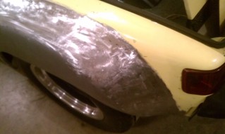

rick 918-S   Starting to shrink the extra metal from reversing ...   Nov 12 2011, 02:10 PM

rick 918-S   Ran out of wire for my mig and gas for my tig so I...   Nov 20 2011, 08:26 PM

rick 918-S   Lots of bumping and grinding yet but here's a ...   Dec 12 2011, 12:04 AM

rick 918-S   More bumping and shaping. the last couple nights. ...   Dec 15 2011, 12:07 AM

rick 918-S   These fronts are going to be a bitch to fit. As I ...   Dec 17 2011, 01:02 PM

rick 918-S   Yep, Very mild here. :D Here's a sample of t...   Dec 18 2011, 12:44 AM
rick 918-S   The flares were too close to the tires so I raised...   Dec 24 2011, 12:28 AM
