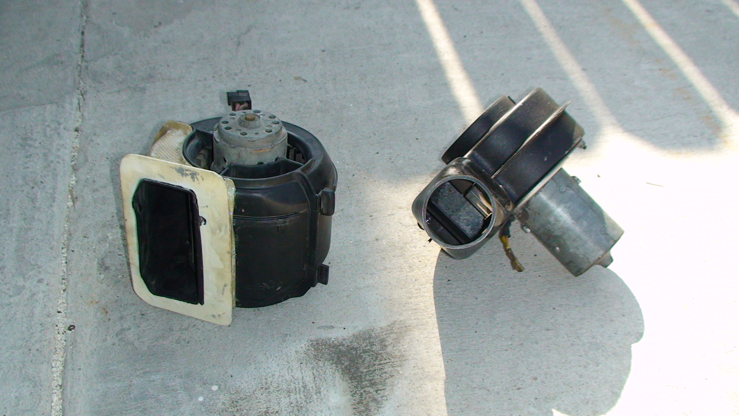

It gets cold here in Northern California often in the moorning. So I decided to build a liquid heater. First, I spent some time measuring the inside of the fresh air box. I figured I could fit a core 11x6 maximum. my son and I spent several hours at the local Pick and Pull junk yard. I settled on a Transmission cooler from a late model Ford Truck. Cooler measures 10x6.
I quick placement and I realize I need to cut! The water dam for the fan must be cut down. Make sure not to cut all of it so that it will still keep some water off the motor.
The finish cut to the dam. Ready for the lid? Not yet.

I am blindly moving forward with this.
I picked up a 3 or 4 speed blower out of a 924, 944 or 928?
It moves a lot more air.
I am now relocating everything in order to make room for it.
