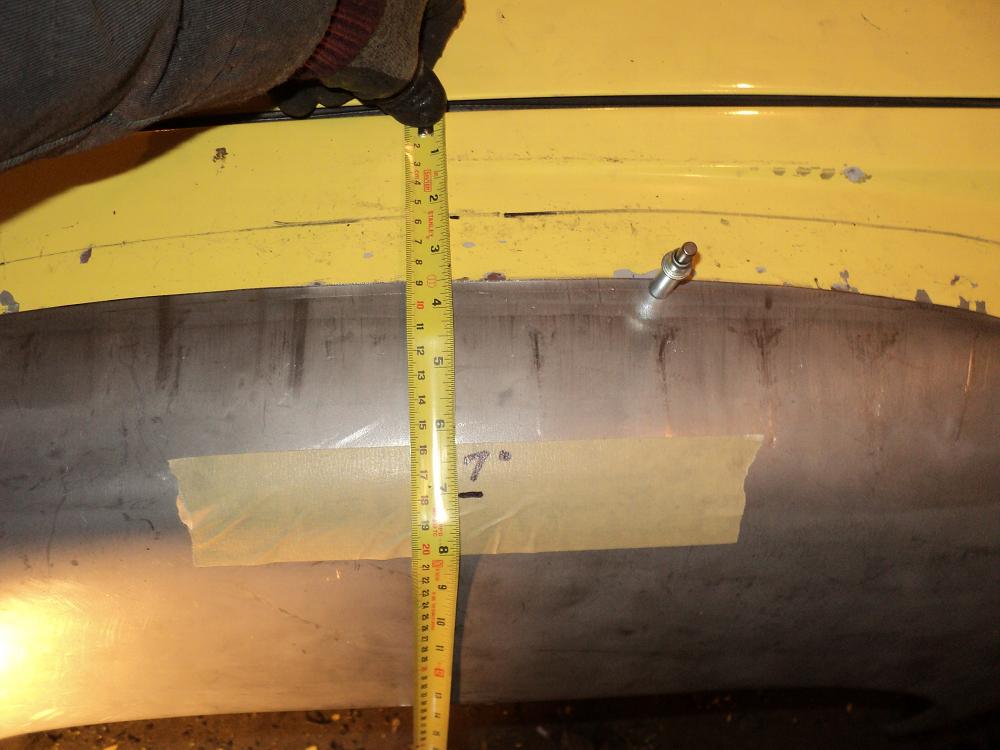

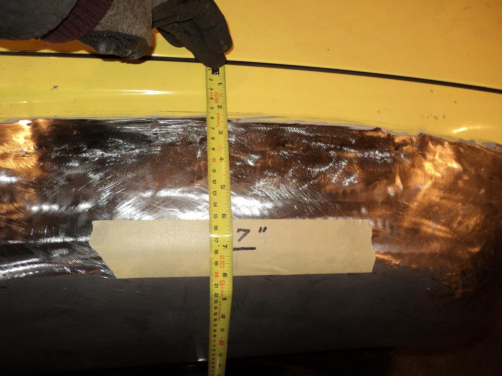

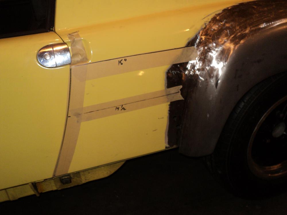

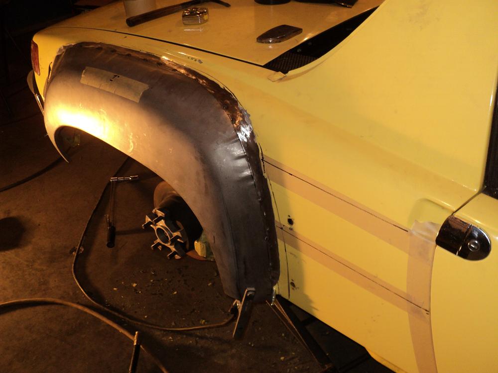

Ran out of wire for my mig and gas for my tig so I'm done for the day. Got the right flare laid out and tacked.
