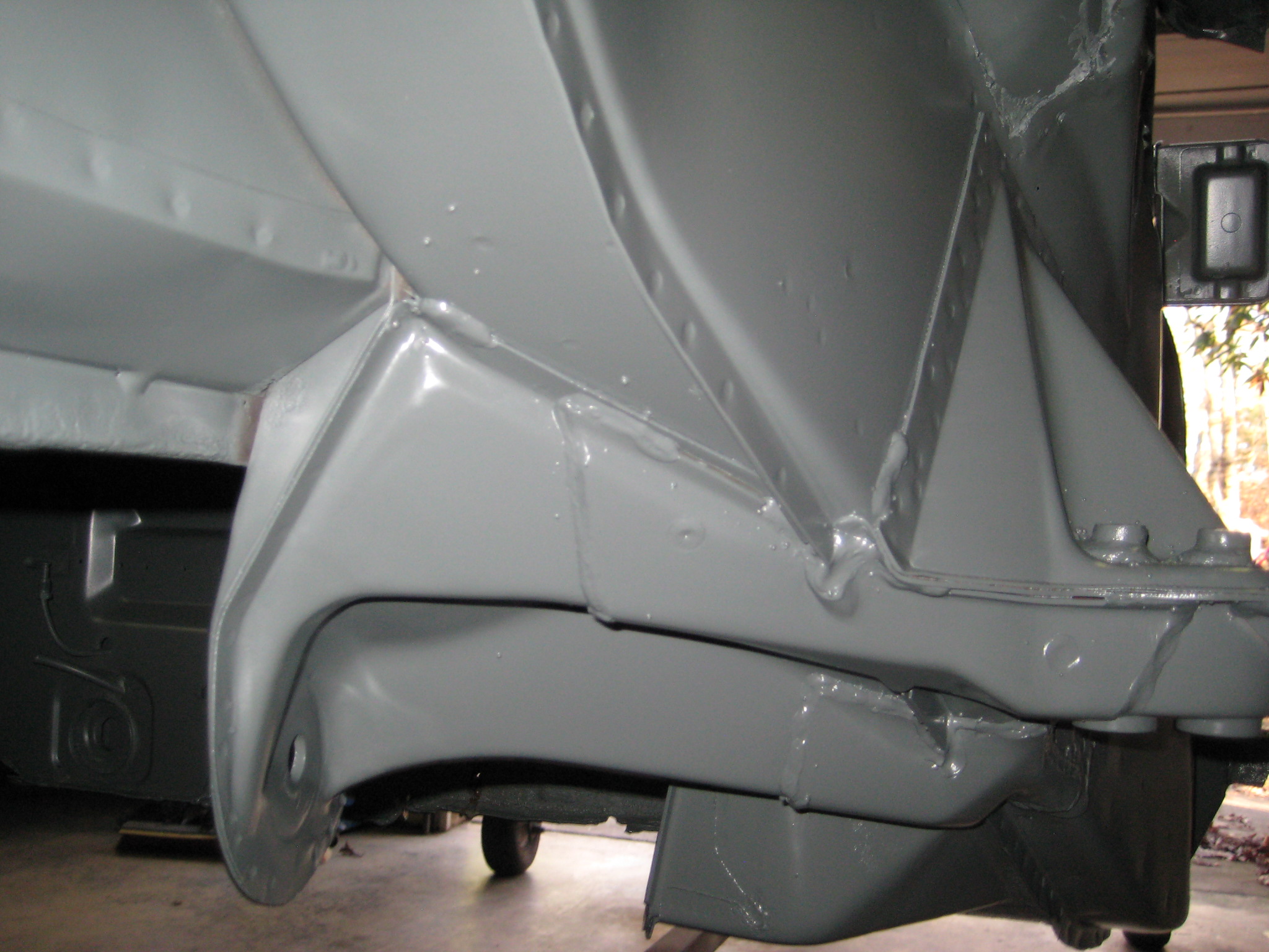

dlee6204   Got some more work done today. I got the jack poi...   Feb 4 2012, 03:49 PM
dlee6204   The story was the same for the other side...   Feb 4 2012, 03:51 PM

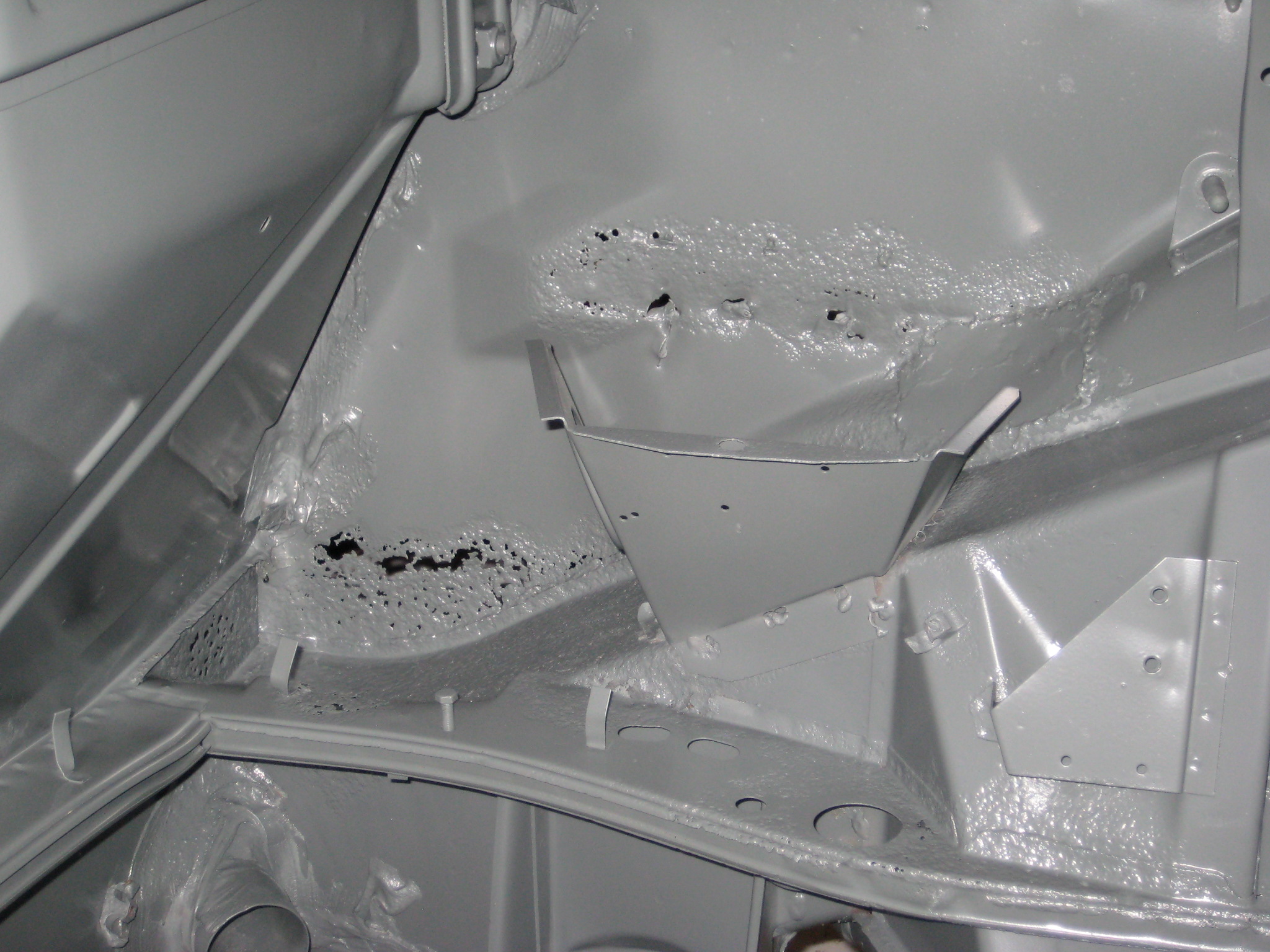

dlee6204   Update: I've been working on a lot of littl...   Feb 23 2012, 08:52 PM
dlee6204   The front trunk floor also has some thin metal wit...   Feb 23 2012, 08:58 PM
dlee6204   I did some work on the lower firewall too. ...   Feb 23 2012, 09:12 PM
