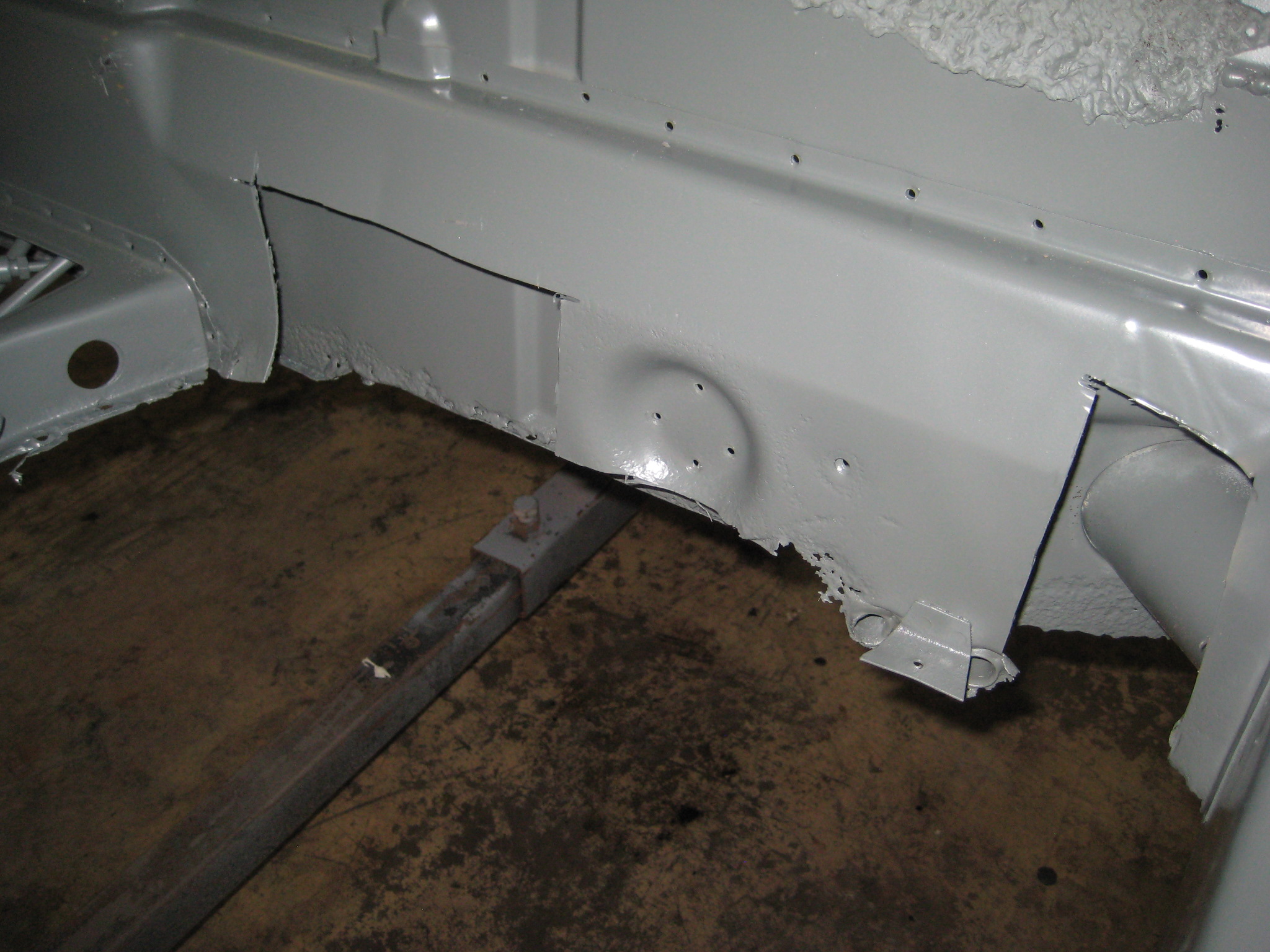

dlee6204   The longs have a little bit of rust which is going...   Nov 26 2011, 09:43 PM
dlee6204   I need to pick up some sheet metal for the long wo...   Nov 26 2011, 09:52 PM
dlee6204   And I made up a panel to replace the area. That...   Nov 26 2011, 10:06 PM

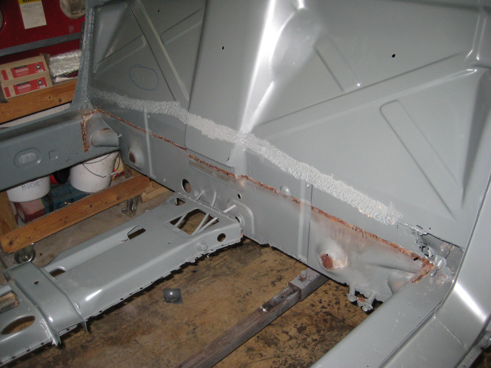

dlee6204   Update: Here is the corner of the firewall welded...   Dec 12 2011, 03:29 PM
dlee6204   I next moved onto the pass. long. Top layer o...   Dec 12 2011, 03:37 PM
dlee6204   Next came the driver's side long which was not...   Dec 12 2011, 03:43 PM
dlee6204   And for the record, I used 18 gauge steel. I...   Dec 12 2011, 03:51 PM
