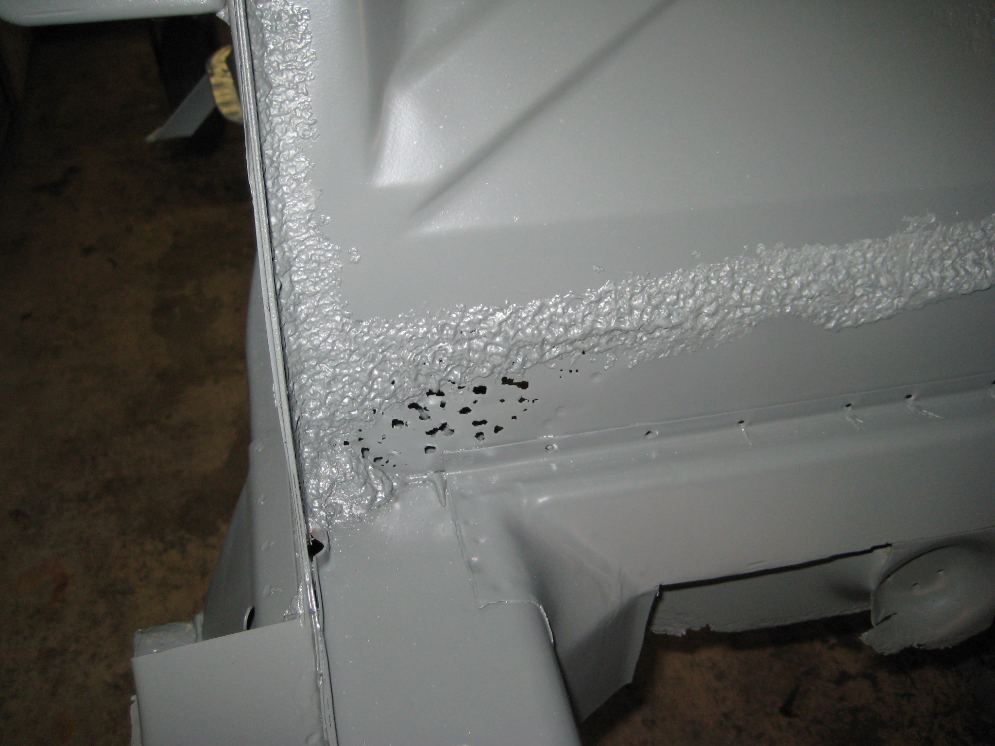

dlee6204   I also spent quite a bit of time prepping the repl...   Feb 5 2012, 09:37 PM
saigon71   Lookin good man! Like the idea of cutting a f...   Feb 5 2012, 10:34 PM

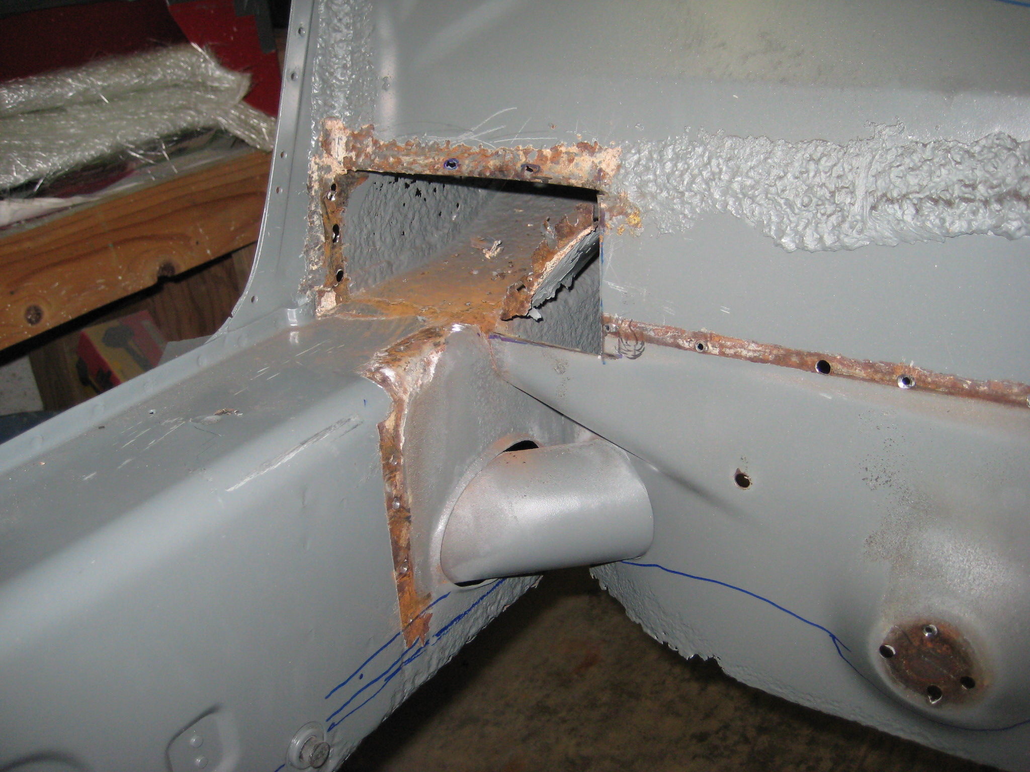

dlee6204   Update: I've been working on a lot of littl...   Feb 23 2012, 08:52 PM
dlee6204   The front trunk floor also has some thin metal wit...   Feb 23 2012, 08:58 PM
dlee6204   I did some work on the lower firewall too. ...   Feb 23 2012, 09:12 PM
dlee6204   Oh and who says there aren't enough spot welds...   Feb 23 2012, 09:14 PM
