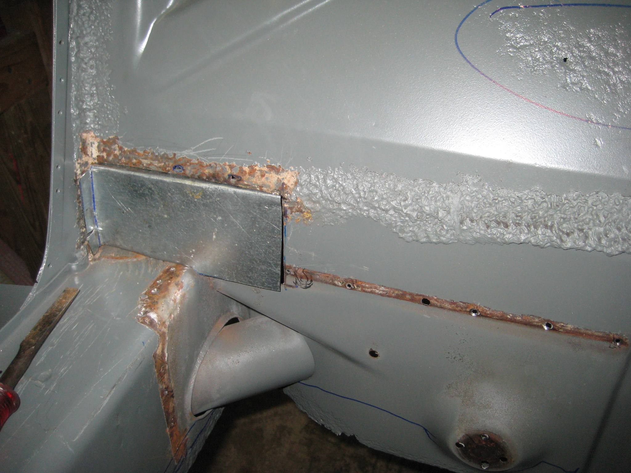

And I made up a panel to replace the area. That's all I got done today. Tomorrow I'll do some clean up, weld this piece in, and get some door braces in before I start the longs.

QUOTE(dlee6204 @ Nov 26 2011, 10:06 PM) *
Please get some mild steel 18/20 gauge sheet metal for your patches. that thin galvinized metel (likely 28 ga.) will not weld very good and will posion you.

dlee6204   The metal I am using is 20 ga. Not the thin stu...   Nov 27 2011, 06:58 AM
