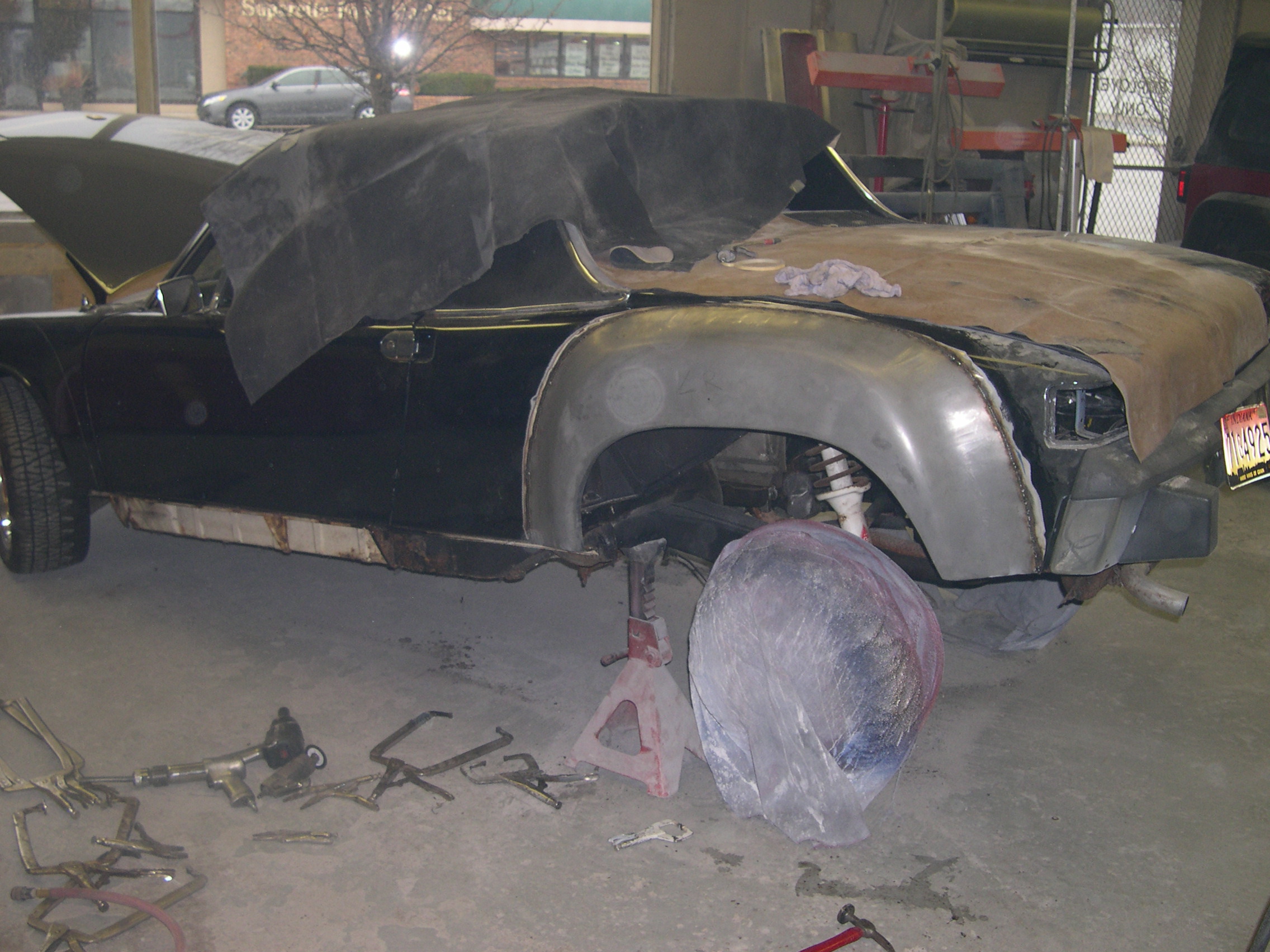

I finally got my flares welded over the Turkey weekend
marking the panels
Attached ImageAttached Image
the cut out
the weld
all welded up

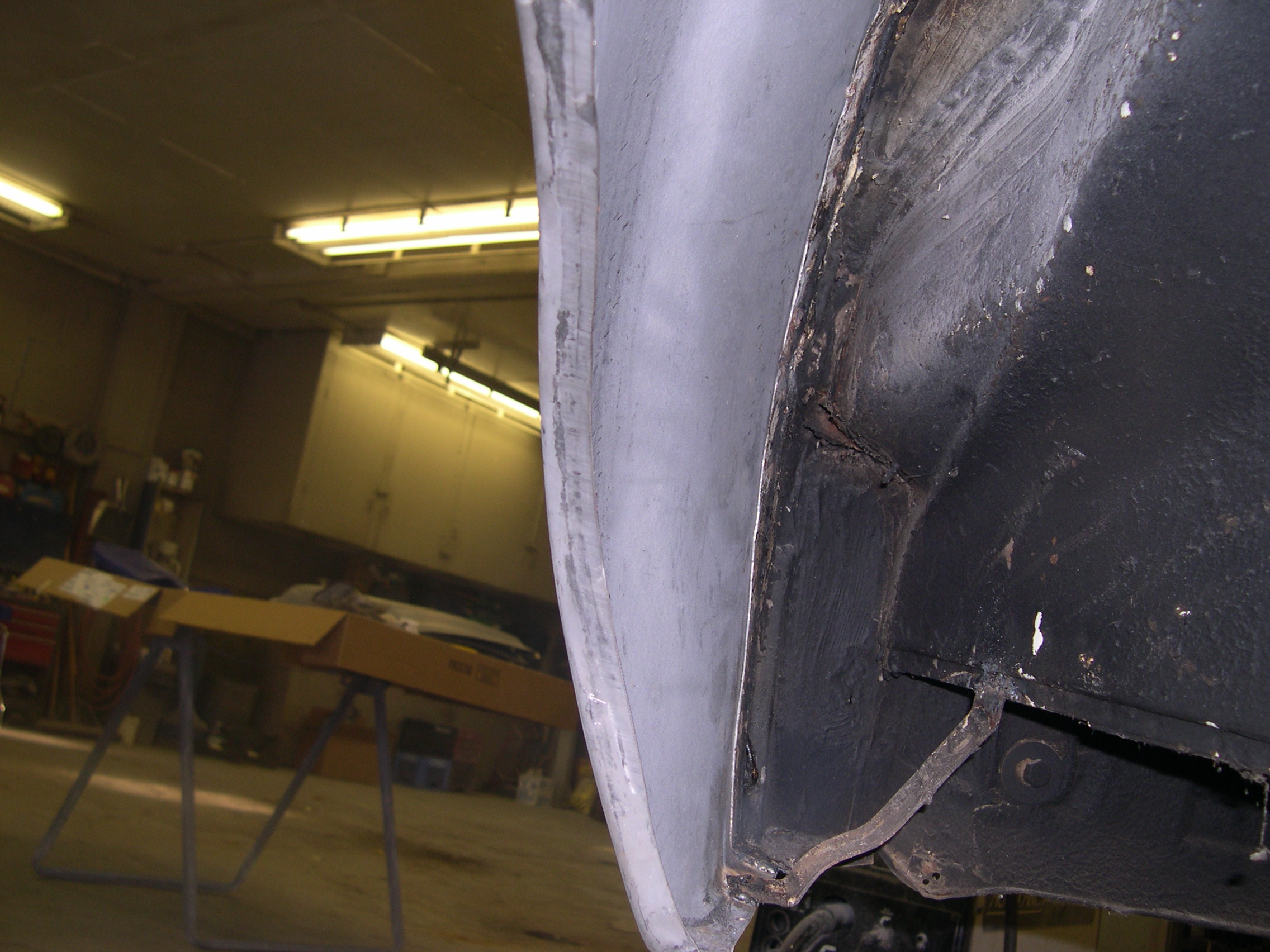

I found a picture of the inside before we ran a weld bead along the seam you see in the picture. Which also shows a little of the bottom edge.

bulitt   Did you butt weld or lap? Did mine last week als...   Nov 29 2011, 05:35 PM

kfish914   Yes, deleted the side marker lights. I had a lot o...   Nov 30 2011, 08:45 AM

patssle   Who's flares are those? And any pics of the re...   Nov 30 2011, 08:59 PM
sean_v8_914   could you please show us a close up of the bottom ...   Dec 1 2011, 07:55 AM
pdlightning   could you please show us a close up of the bottom...   Dec 1 2011, 10:44 AM
mepstein   could you please show us a close up of the botto...   Dec 1 2011, 11:23 AM
kfish914   If I were to do it over I would butt weld. Only b...   Dec 1 2011, 09:39 PM

kfish914   I found a picture of the inside before we ran a we...   Dec 1 2011, 11:00 PM
PRS914-6   The flares and fiberglass parts need SIGNIFICANT w...   Dec 10 2011, 10:33 AM

PRS914-6   Is your rear valance metal or fiberglass? If y...   Dec 10 2011, 05:50 PM
