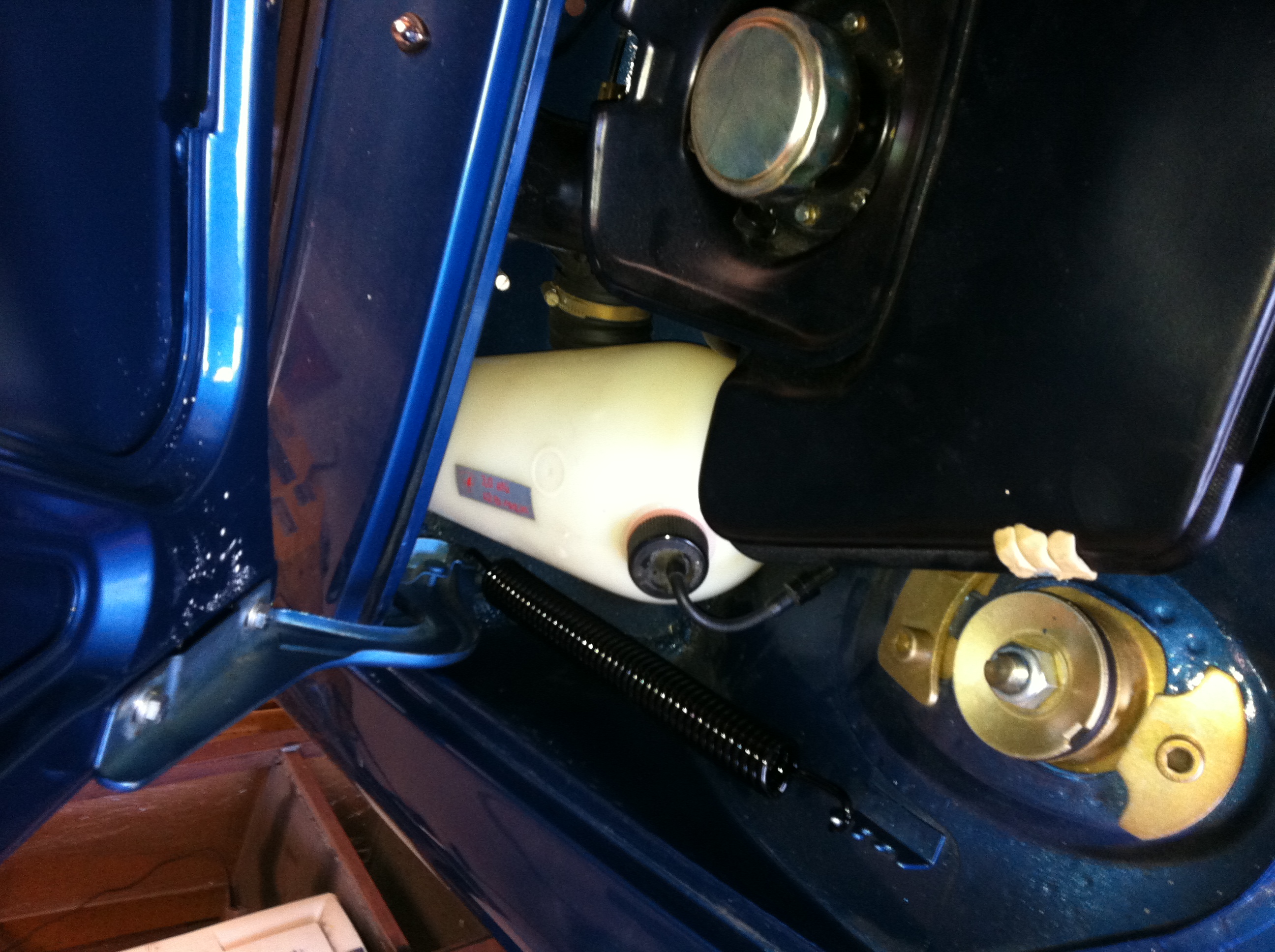

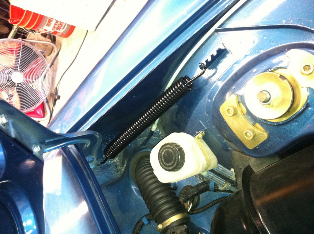

I sent my hood springs out for powder coating. I need a way to spread the springs apart to get a good coating. Seems to have worked well!!

Have you installed them yet? I was worried about the paint 'blocking' once the front trunk was closed. I also thought that a thicker coat of paint, which the powder coating should be, would help isolate the springs from making that noise they make when you open the hood.

Installed and seem to work fine
