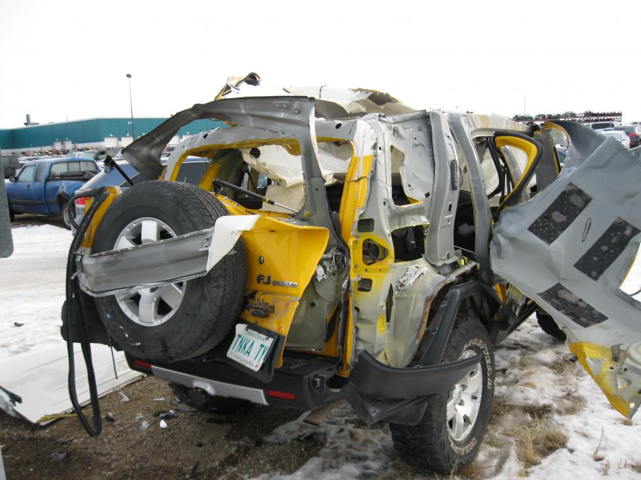

This is reposted from another forum.....
Quote "So my time almost came to an end this morning... im very lucky to be alive. First of all, GO HUG YOUR WIFE/HUBBY and tell them you love them. i had an acetylene bottle in my truck, the valve was bumped so slightly and over night the truck filled with the gas. i noticed the smell, and opened the doors to air out the truck. i drove the truck out of the garage to get some more air movement. i went to roll the pass side window down and as soon as i touched the power windows. BAM. with me in the truck. i lost all hearing out of my right ear and got a scratch on the back of my head. all things considering, im alive. so now ive got the question out to toyota about a 2012 TT. 125 to canada only, 15 in standard. i want a standard... pictures tell 1000 words. dont take any minutes or seconds you have for granted... it may be your last... peace everyone," |

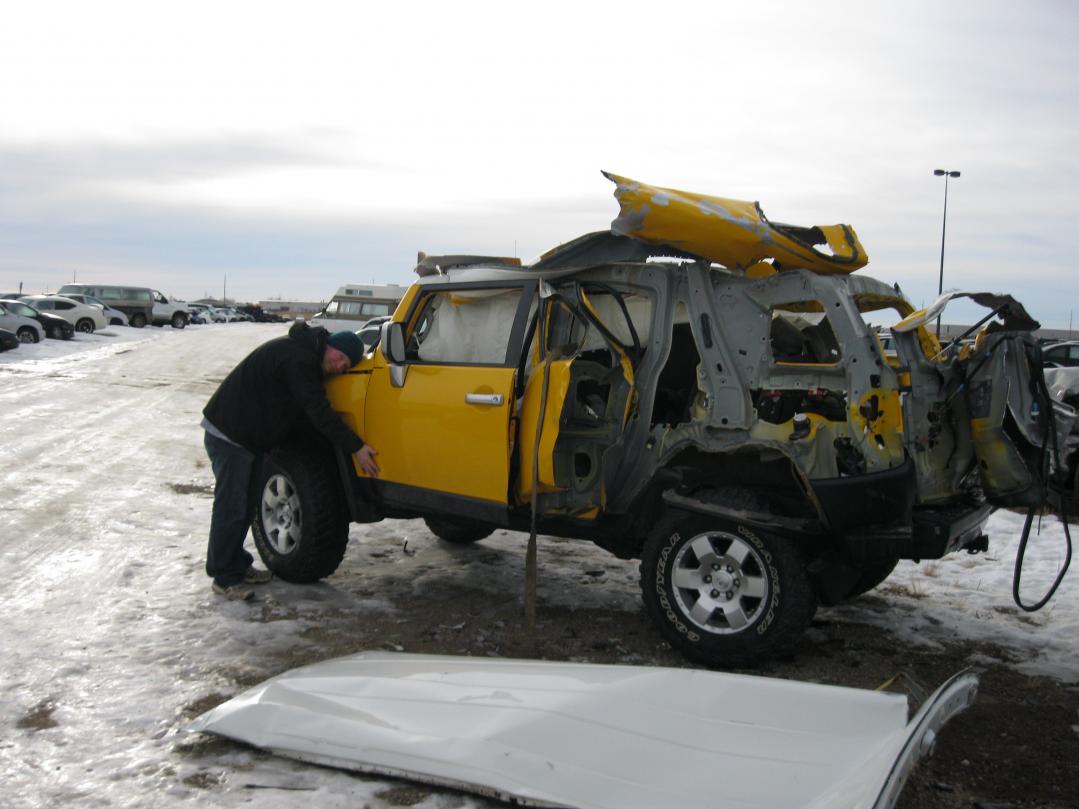

URY914 And the pictures..........

Mark Henry I'm amazed at how it peeled all the outer skin... Dec 3 2011, 02:18 PM
URY914
I'm amazed at how it peeled all the outer ski... Dec 3 2011, 03:09 PM

rick 918-S The question I have about this is where is the the... Dec 3 2011, 03:36 PM
scotty b :agree: on the cap. no welding shop would fill a ... Dec 3 2011, 03:53 PM
phatnine11 You had an Angel on your back! When I took my ... Dec 3 2011, 03:55 PM
scotty b I'd alo like to know how one could be on the i... Dec 3 2011, 03:56 PM
Dr Evil I call :bullshit:
Scott and Rick said why. Dec 3 2011, 05:50 PM
Dr Evil Is acetylene not odorized? I forget. LPG and LNG a... Dec 3 2011, 05:52 PM

scotty b notuce how the panels peeled. Back and to the righ... Dec 3 2011, 06:03 PM
Bruce Hinds Since he said he let it air out before he hit the ... Dec 3 2011, 07:30 PM

zambezi My guess is that since the drivers door is fairly ... Dec 3 2011, 07:59 PM

Brodie We work with Acetylene every day, and I know that ... Dec 4 2011, 08:03 AM
URY914 Someone on another forum said that if he opened th... Dec 4 2011, 08:13 AM
zambezi If the door was open there would have been plenty ... Dec 4 2011, 09:01 AM
ellisor3 I would think the shock wave alone would have done... Dec 4 2011, 09:28 AM
Dr Evil After looking at the pics it is obvious that a rap... Dec 4 2011, 09:31 AM

Racer Chris I agree with the theory that the concentration was... Dec 4 2011, 10:19 AM

scotty b you guys seem to be focusing on the soot when igni... Dec 4 2011, 07:44 PM

Based upon how the body panels are pealed off, ... Dec 5 2011, 02:11 PM
