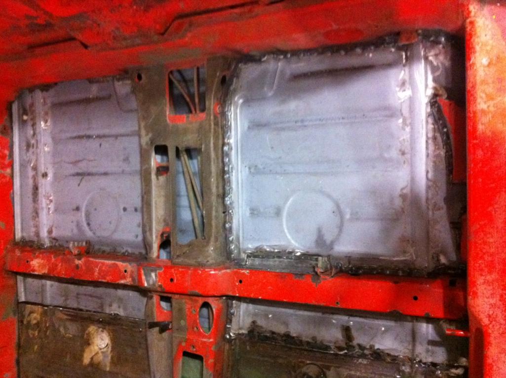

While I save up some more $$ for engine parts I have gone back to welding the floor in.. I've finished welding the underside 3 sides to the floor pan and have now started on the top side.. I have the tunnel welded to the floor pan and the whole square where the drivers seat mounts, and most of the drivers side seam from old to new pan.. My welding is getting better ( I think ).. I keep checking with a hammer/screwdriver to break the welds and they're strong.. This is the first time I've welded since a couple days in high school so its a big learning curve. Its coming along nicely I think... Attached Image
Slow and steady, good to see you are still at it! The biggest thing when welding is keep everything clean, its looking good. Before you know it (IMG:style_emoticons/default/driving.gif)
