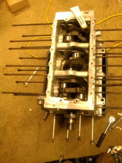

Engine parts arrived last Tuesday (IMG:style_emoticons/default/piratenanner.gif) , although it was 6 days from when I expected them. (IMG:style_emoticons/default/sad.gif)
Worked on it this weekend got the cam, crank and case together
(IMG:http://www.914world.com/bbs2/uploads_offsite/i384.photobucket.com-9514-1323140442.1.jpg)

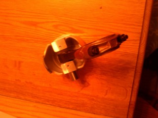

Project came to a stop with the next step. Had to put the wrist pin in. Heated the rod end as I was told to do, wrist pin was supposed to slide right in, it didn't. I then I went the other direction. Picked up dry ice. Wrist pin slid through the rod and stopping before exiting the other side.
(IMG:style_emoticons/default/headbang.gif) (IMG:style_emoticons/default/headbang.gif)
(IMG:http://www.914world.com/bbs2/uploads_offsite/i384.photobucket.com-9514-1323140442.2.jpg)
Have a 6 ton press, however since I have never did wrist pins, I can only see bad things happening. So off to local engine rebuilder to get this done.

rick 918-S
post Dec 5 2011, 10:27 PM
Hey nice rack! -Celette
Posts: 21,356
From: Now in Superior WI
Member No.: 43
QUOTE(914coop @ Dec 5 2011, 09:00 PM) *
Irv
Yes, bring them to someone that does that lots! I took a break from welding to put up some shelving, get my engines sorted and stored under the work bench and get Sandy's 914 running. Welding starts again this week. Nice to see you finally got your engine parts. (IMG:style_emoticons/default/beerchug.gif)
