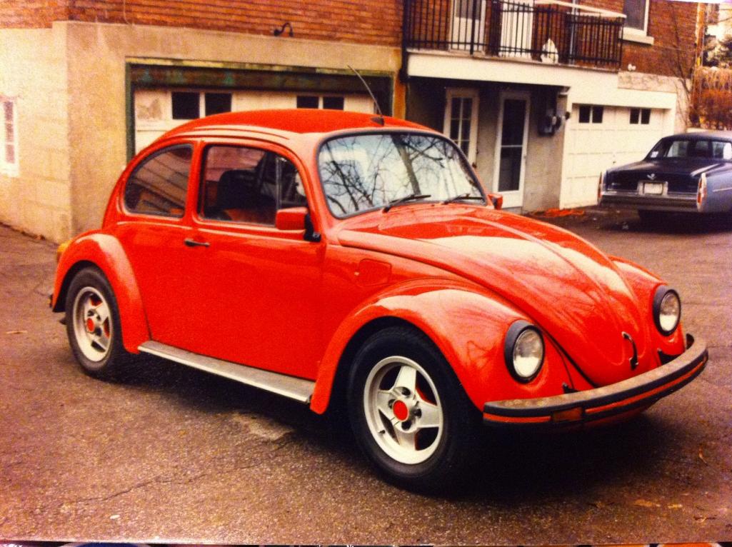

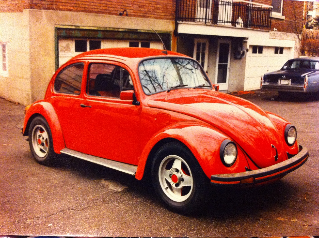

Keep up the good work. I feel your pain dealing with the rust. Did this with my Beetle in Montreal 25 years ago.
BTW, nice wheels... (IMG:style_emoticons/default/biggrin.gif)
