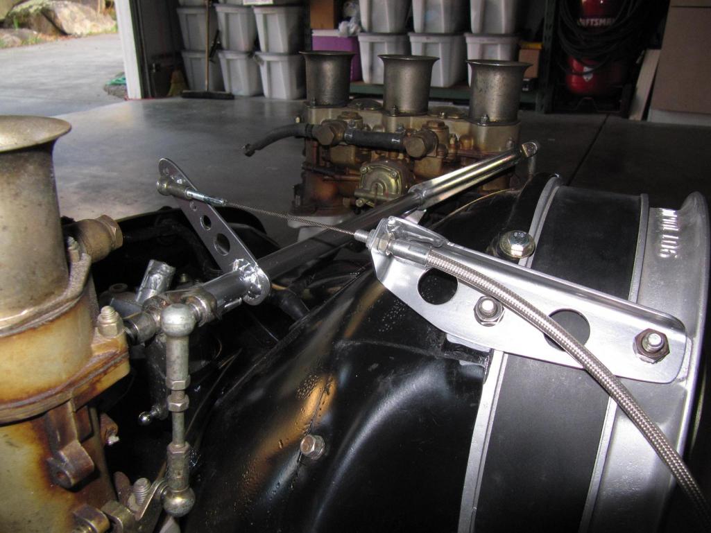

So I have been working on my car and its been nearly a year since I've updated. My new economy throttle linkage. $15 for two of the ball joints that the cable goes to (one spare). My goal was to get rid of the monkey motion, use a stock throttle cable and not spend much. I am using an aftermarket 914/6 cable from Patrick motorsports $50. I bought two so I'd have a spare. This set up has been tested with the engine rolled under the car and the cable installed in the car with the pedal assembly. I get full throttle and still have some adjustment that I can make to the rod lengths, cable length or bracket position.
