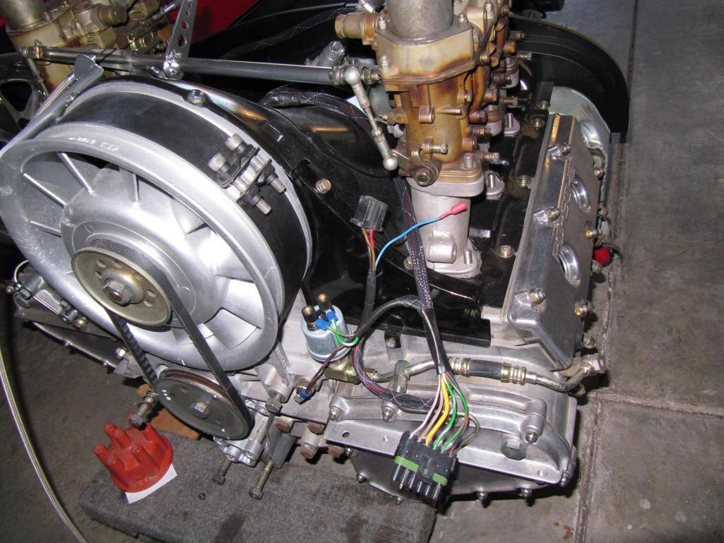

Since this car is such a mix of parts I needed to make my own wire harness. I also wanted to eliminate the relay board. This is not a fancy connector. I found it was a big hassle trying to find just one male/female connector. I called JEGS and ordered a weather pak unit.

Krieger   Since this car is such a mix of parts I needed to ...   Dec 9 2011, 06:41 PM
Krieger   Here is the rest of the harness. Most of my suppl...   Dec 9 2011, 06:52 PM

Krieger   Here is the engine compartment with my new connect...   Dec 9 2011, 07:22 PM
