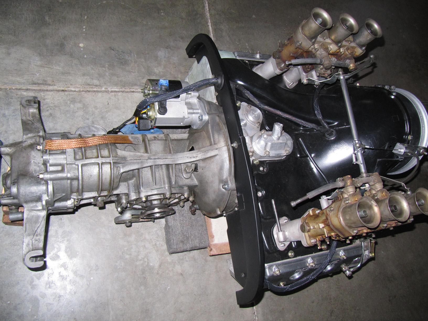

Here is the rest of the harness. Most of my supplies came from a local electronics supply. For the actual wires within the harness I cut the rear half of the wire harness from a 914 that was at my local pick n pull. It was in great shape. I used these wires in my new engine harness so they would match the wires in my body harness when pluggen in. Hi torque starter. Ottos built trans. I put the heavy cable from the battery to the starter in the harness as well.

Krieger   Here is the rest of the harness. Most of my suppl...   Dec 9 2011, 06:52 PM
