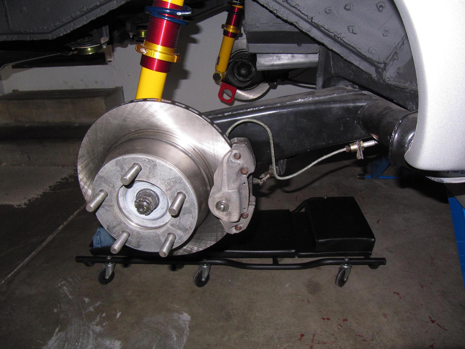

Here is one of my rebuilt Ferrari rear calipers. All I need for the rears are pads!

Krieger   Here is one of my rebuilt Ferrari rear calipers. ...   Dec 9 2011, 06:57 PM
