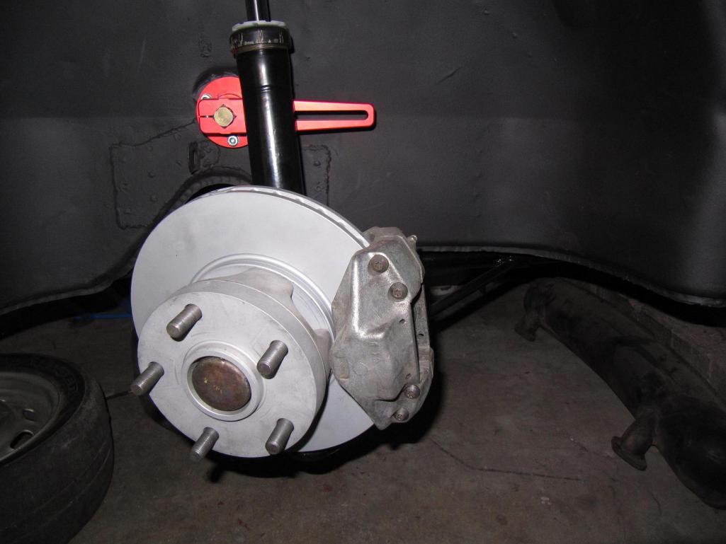

Front sway bar and heavy A calipers. When I learn how to drive I will replace the A's with something better. I need to run brake lines and add master cylinder.

Krieger   Here is one of my rebuilt Ferrari rear calipers. ...   Dec 9 2011, 06:57 PM
Krieger   Front sway bar and heavy A calipers. When I learn ...   Dec 9 2011, 07:02 PM
