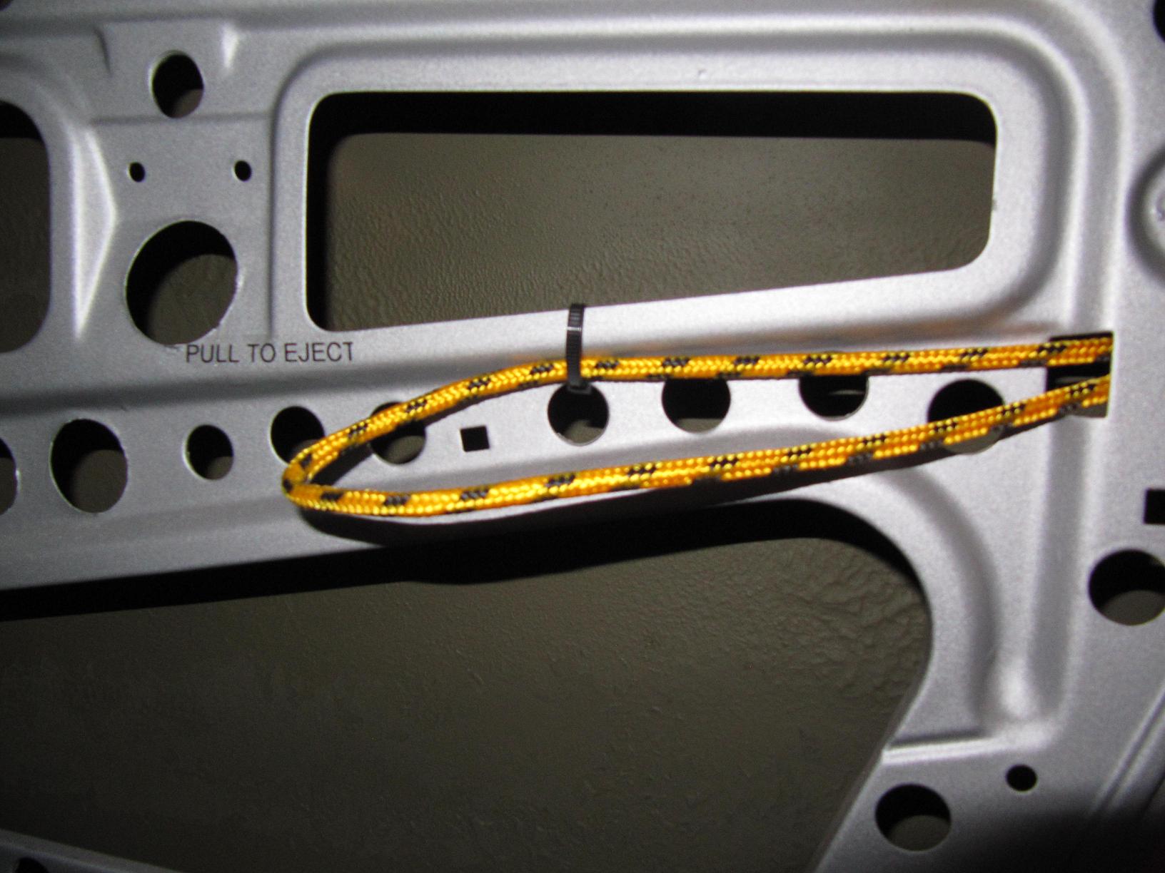

Something simple, cheap, light and fun. If you were in a US made jet and wanted to get out of a plane in a hurry you'd reach up above your head and grab yellow/black cable like this to punch out. Home Depot special $9. Eject label from office label maker free. Effect...priceless (IMG:style_emoticons/default/biggrin.gif)
