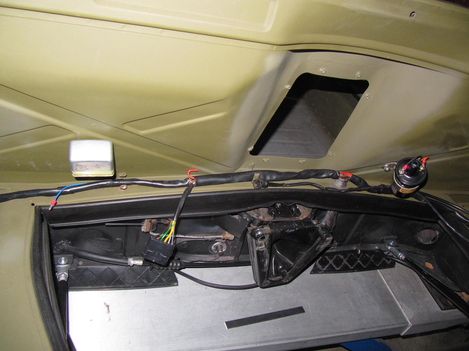

Here is the engine compartment with my new connector eliminating the use of the relay board. I shortened a good amount of the original harness to put the plug in this location. The voltage reg was the only "compromise" if you want to call it that. I have the bracket for the engine mount temporarily mounted to help me with figuring out the oil line routing. My coil is wired in to the body harness and so is the distributor pick up lead.
