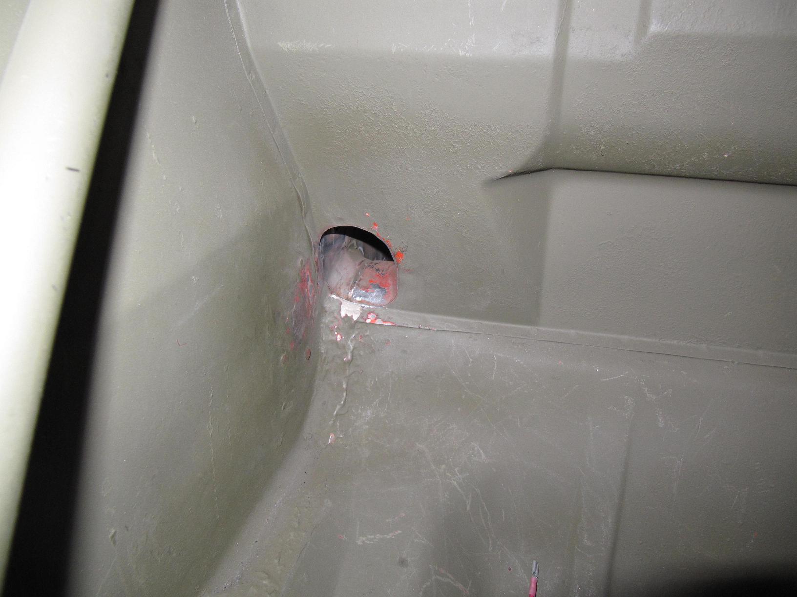

Oil line routing in front trunk. The lines are going in the passenger long, then into the passenger compartment. Through the front bulkhead to the cooler. (IMG:style_emoticons/default/sawzall-smiley.gif)
