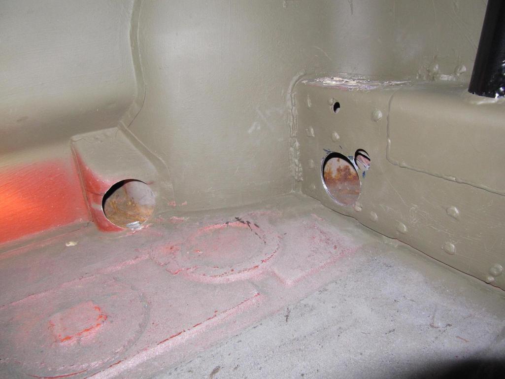

Krieger   Oil line routing in front trunk. The lines are go...   Dec 9 2011, 07:28 PM
Krieger   Passenger side. Hole saws courtesy my pal Marty. ...   Dec 9 2011, 07:32 PM
