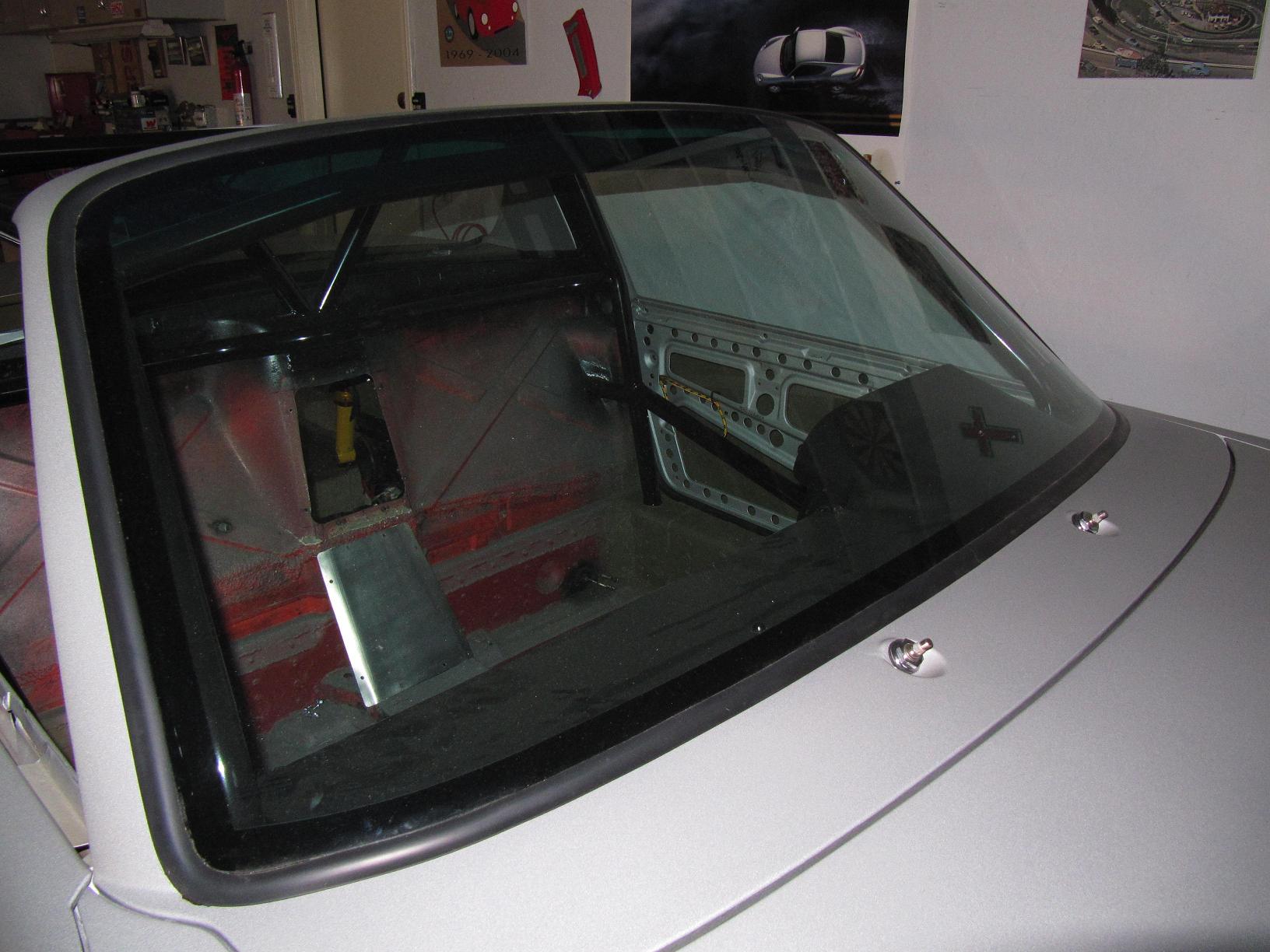

Windshield from that same doner car at pick n pull. It has a couple of small scratches otherwise awesome shape. I got it out, home and installed without breaking it! Rubber seal/butyl from Mikey. 3m black primer.
