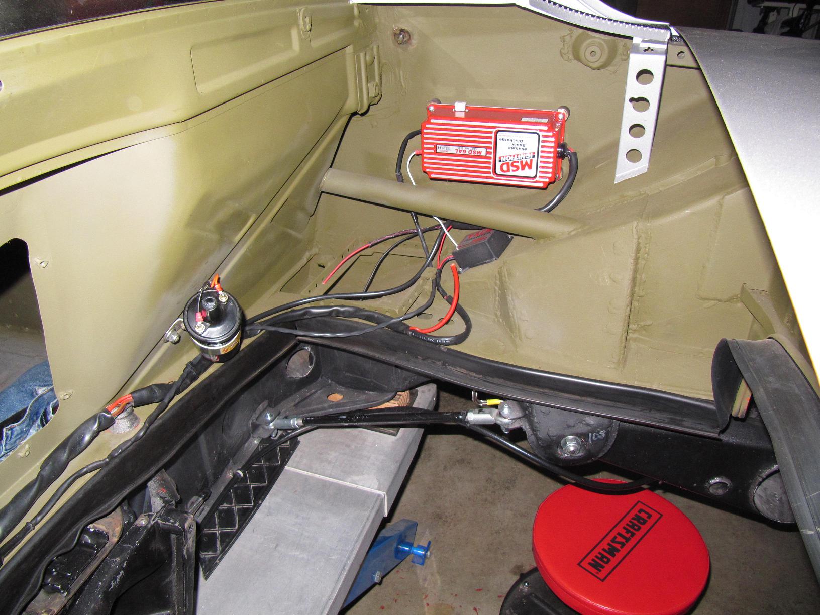

Almost forgot. The MSD 6AL box is wired into the harness along with the tach adapter. All I need is a couple of ends installed.

Jeffs9146   What year 3.0L is it? I didn't need a tach ada...   Dec 9 2011, 11:33 PM
Phil Plummer   What year 3.0L is it? I didn't need a tach ad...   Jul 21 2012, 05:03 PM
Krieger   The engine is from a 78. The tach is from an unkn...   Dec 10 2011, 09:05 AM
