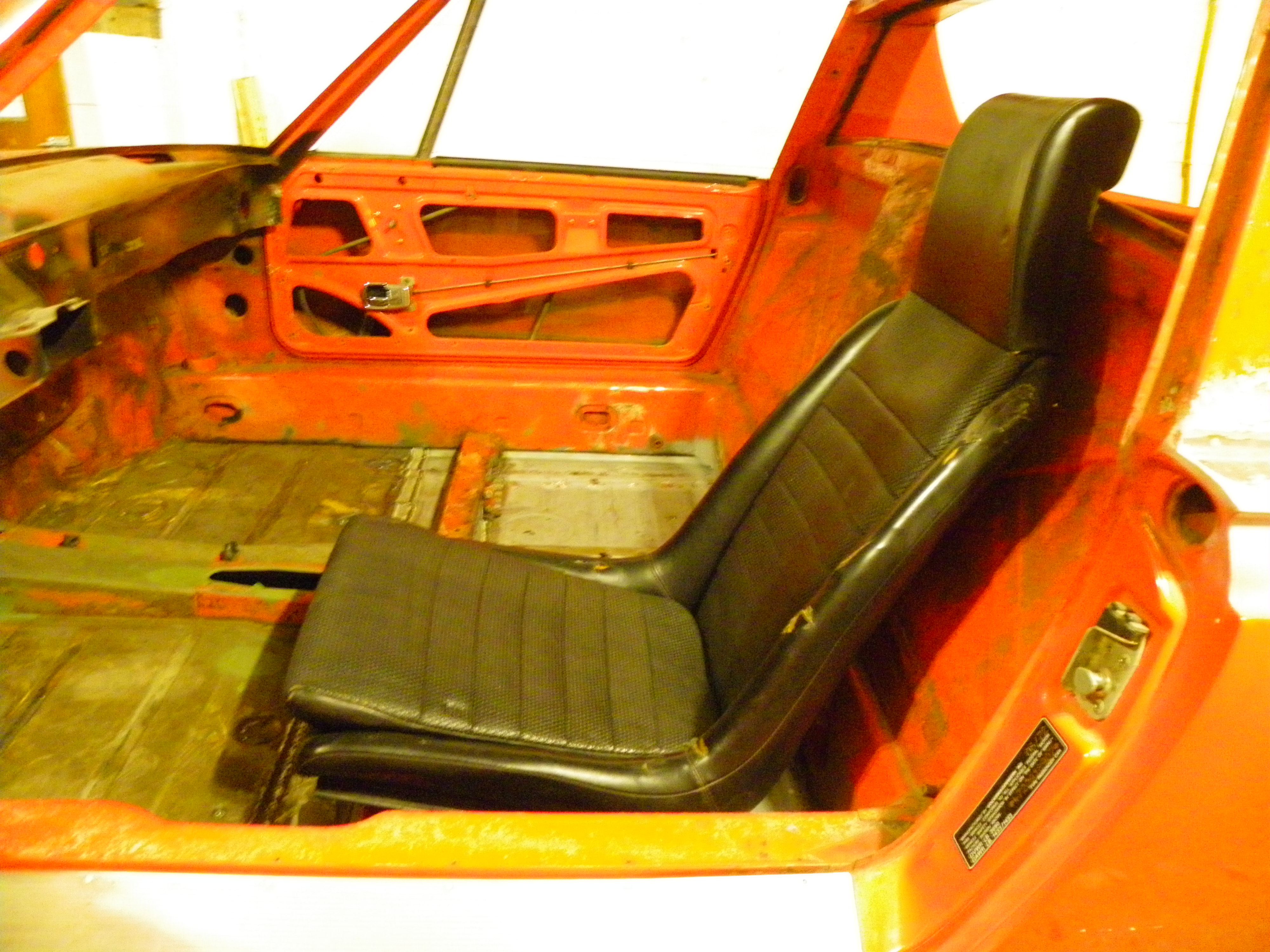

Other than some touch-ups I have to do around the firewall but I got the floor finished up today.
Welded in the drivers seat mounts. Cant weld in the pass. seat mounts until I acquire a pass side seat track..
Figured I would put the drivers seat in and see how it fits up..
